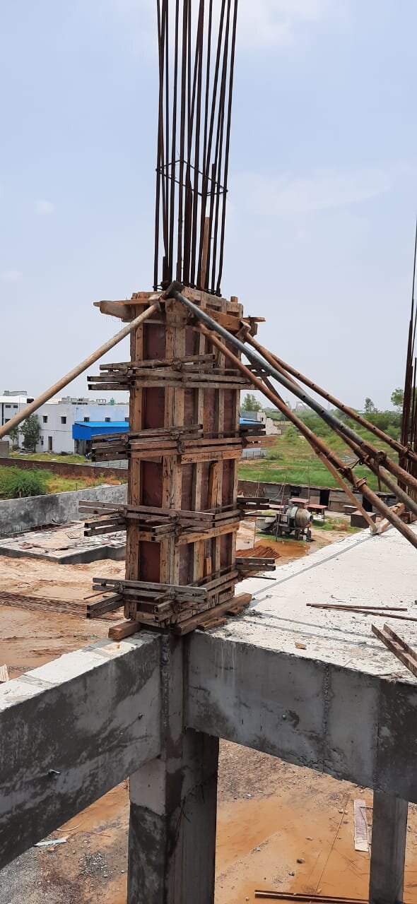

Can I do Overlapping of Reinforcement near to Column lift Joint?

The lapping of column reinforcement bar should not be done at column beam junction as the maximum forces are acting at it.
You can search forum to get details of it, there are already detailed answers in this section.
