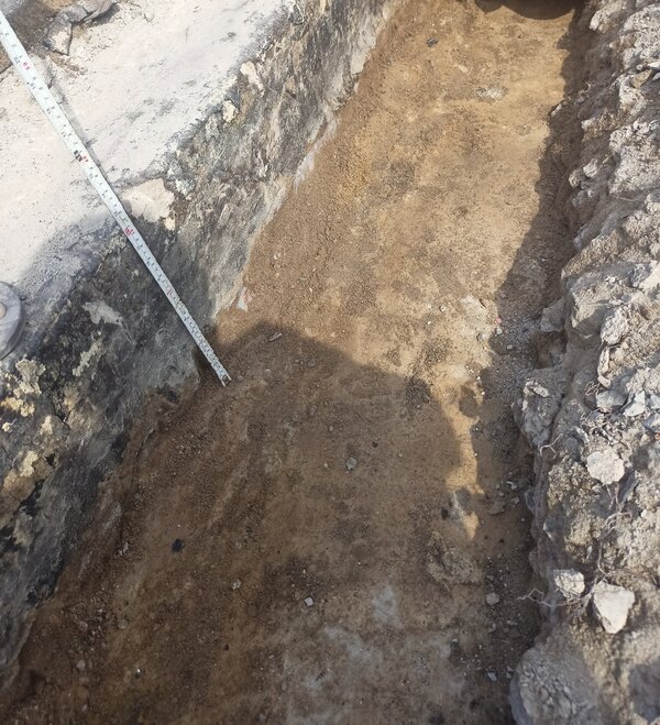

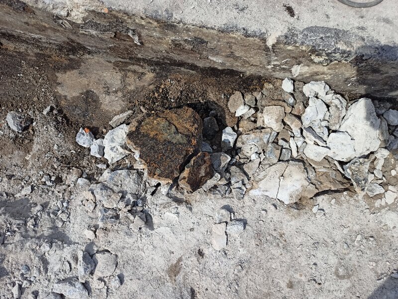

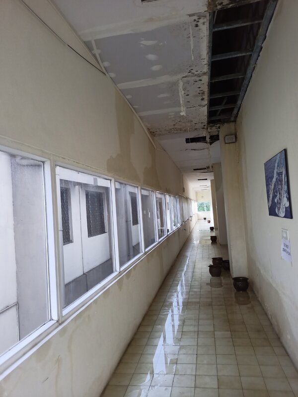

Pl suggest for treatment of lekage from face of beam and slab junction as suspected in old slab
