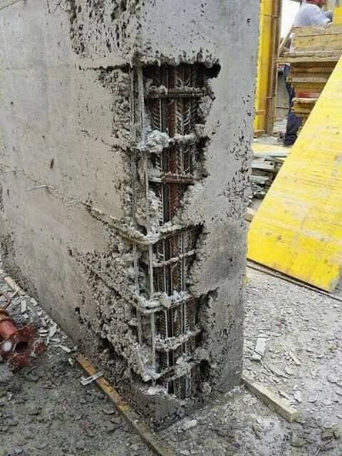

It can be called as lack of supervision while execution of the work.
It look like lapping of column reinforcement bars done at lower level such a that, there is no space left for concrete to travel.
Leaded to honeycombing with exposed reinforcement bars.
Also there is lack of cover to reinforcement bars seen which is not good from durability point of view for the structure.
Possible remedy option is only to break the column and correct lapping of reinforcement bars to allow concrete to pass through it.
