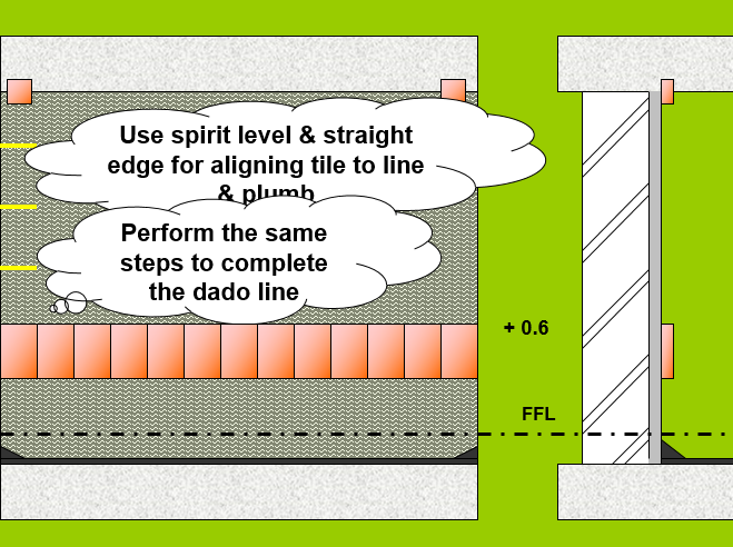

It shows how to do a dado work in Toilet (Wall tiling activity)

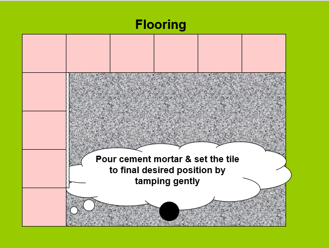

it explains about how to proceed with flooring activity.

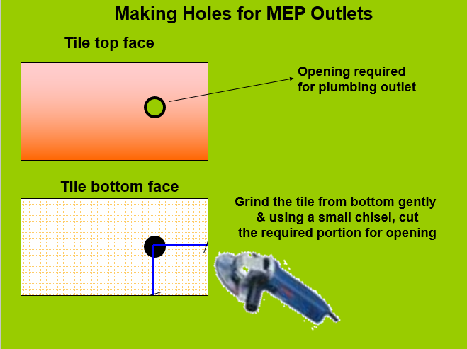

how holes should be made in ceramic tiles for MEP works.

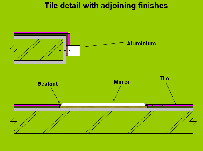

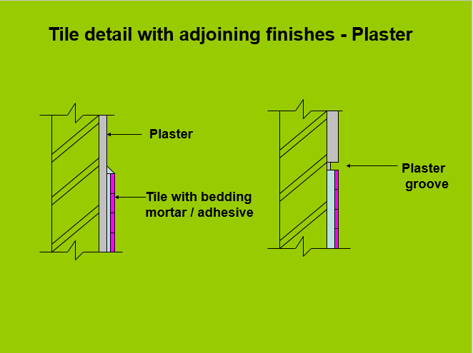

It gives you complete idea about how to pre-plan everything by looking at other finishing details before starting work.
Such as wall plaster finishes

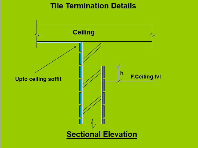

where the tiling to be terminated on walls

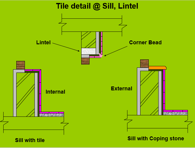

detailing at sill, lintel levels
