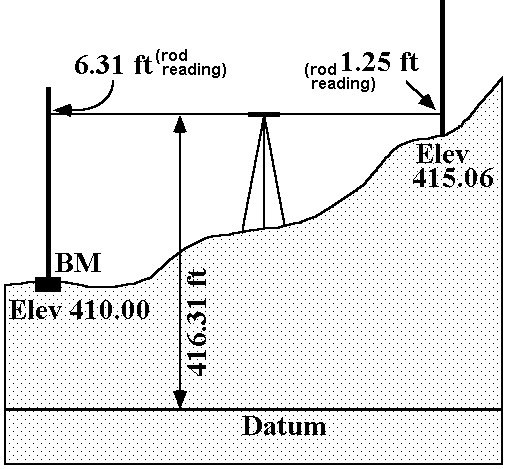

Add rod readings (BS) to benchmark or known turning point elevations to get the elevation of the line of sight (HI).
Subtract rod readings (FS) from the line of sight to establish elevations of unknown points.
Repeat over and over.
SCHEMATIC
Elev + BS = HI
HI - FS = New Elevation

SCHEMATIC
Elev + BS = HI

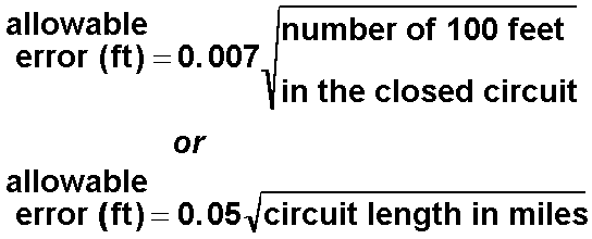

The difference between the beginning and ending elevations for a loop or the difference between the ending elevation and the known elevation of the ending BM.
For this class we will use the standard established for Third-order surveying.
