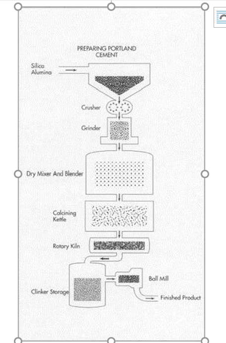

- The first step in making concrete is to prepare the cement. One type of cement, Portland cement, is considered superior to natural cement because it is stronger, more durable, and of a more consistent quality. To make it, the raw materials are crushed and ground into a fine powder and mixed together. Next, the material undergoes two heating steps—calcining and burning. In calcining, the materials are heated to a high temperature but do not fuse together. In burning, however, the materials partially fuse together, forming a substance known as "clinker." The clinker is then ground in a ball mill, a rotating steel drum filled with steel balls that pulverize the material.
