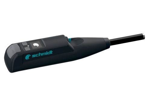

🔎 What is a Rebound Hammer?
A Rebound Hammer is a small, handy device used to check how hard and strong concrete is.
It helps engineers test concrete without breaking it, which is why it's called a non-destructive testing tool.
⚙️ How Does Rebound Hammer Works?
  • Rebound Hammer has a spring-loaded hammer inside.
  • When pressed against the concrete surface, it releases and hits the surface.
  • The Rebound Hammer then bounces back (rebounds).
  • The rebound value is shown on a scale – this number helps estimate the concrete’s compressive strength.
📊 What Do the Results Mean?
  • A high rebound number means the concrete is hard and strong.
  • A low rebound number means the concrete may be soft or weak.
Rebound values help in assessing concrete quality quickly, especially when lab testing isn’t possible.
🧱 Why is it Important in Concrete and Structural Testing?
✅ No Damage: It checks strength without damaging the structure.
✅ Time-Saving: Gives quick results on-site.
✅ Used for Old & New Buildings: Ideal for both new construction and old buildings under inspection.
✅ Helps in Safety Checks: Helps detect weak zones that may need repair.
✅ Cost-Effective: Reduces the need for expensive lab tests.
The rebound hammer is a smart and simple tool that helps in maintaining quality and safety in concrete structures. Whether it’s a road, bridge, or building, this small device helps engineers make quick and confident decisions on-site.
