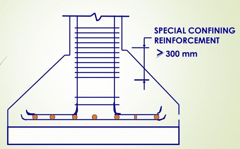

What to do in detailing of foundation, slab, beams, columns and mostly used other structures.
Almost everything in reinforcement detailing, including correct and wrong practices with sketches explained in presentation.

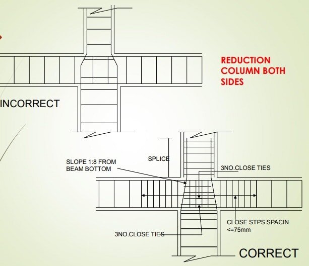

Like how to reduce the column and where it should be done.

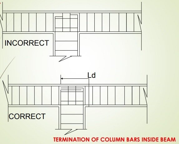

The way of correctly terminating column reinforcement in detailing.
