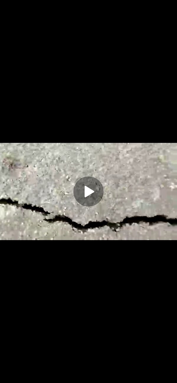

Hello engineers,
I have observed some shrinkage cracks on the slab after 24 hrs of casting,how they will occur and how to eradicate such cracks,please explain the procedure to rectify the cracks

Kindly refer the article of how to rectify simple and shrikange craks.it might give some in sight
It looks like very high amount of admixture dosage in concrete which made concrete to behave like plastic after 24 hours.
Consider removing of that patch of concrete from slab as the movement on it makes internal cracking and setting might take more than a week time.
Look for a batch report and correction details. Sharing more information about that concrete will help you to get more details of causes and avoiding such incident again.
