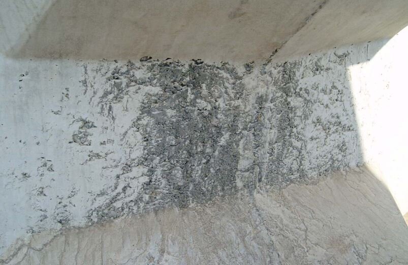

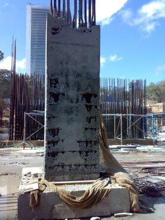

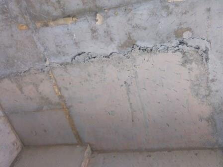

Honeycomb
Honeycomb is a condition of irregular voids due to failure of the mortar to effectively fill the spaces between coarse aggregate particles. Where bridging of the aggregate particles or stiffness of the mixture is a cause of honeycomb, vibration may assist in overcoming the bridging by increasing the flowability of the concrete. Factors that may contribute to honeycombing are: congested reinforcement, insufficient paste content, improper sand-aggregate ratio, improper placing techniques, quick setting on hot concrete, and difficult construction conditions. Changes in mixture proportions to improve workability may assist in reducing or preventing honeycombing.

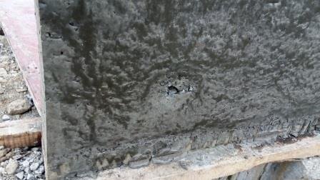

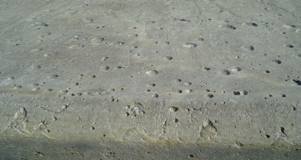

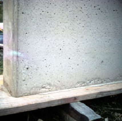

Bugholes (Air surface voids)
Bugholes on vertical faces are normally caused by air bubbles, but occasionally by water entrapped between the concrete mass and the form, especially in sticky or stiff concrete mixtures of low workability which may have an excessive sand and/or entrapped air content. Also, the use of vibrators of too large an amplitude or the lack of complete insertion of the vibrator head may result in increased air-void formation. Air voids vary in size from microscopic to about 1 in. (25 mm). Rarely will water create bugholes on formed surfaces. Excess water normally manifests itself in other textural defects such as bleeding channels or sand streaks on vertical formed surfaces. Bleed water voids can form at the top of a column and on battered formed surfaces.

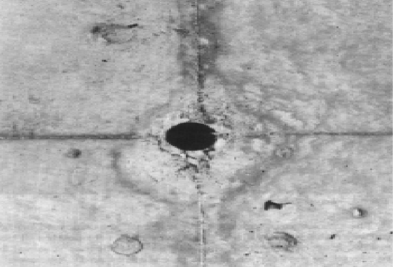

Form Streaking
Form streaking is caused by mortar leaking through form joints and may be aggravated by over vibration from vibrators that are too powerful, or by using forms that vibrate excessively during consolidation. Placing excessively wet or high-slump concrete mixtures will result in more mortar washing out through tie holes and loose fitting forms. Special care is sometimes required when superplasticizers are used, as they tend to increase leakage at form joints and in pump lines.

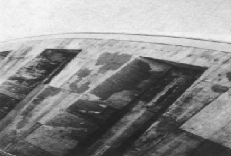

Aggregate Transparency
Aggregate transparency is a condition characterized by a mottled coloring on the surface which results from deficiencies in the mortar. It may result when concrete mixtures have low sand content, dry or porous aggregates, or high slump with some lightweight and normal weight aggregates. Also, high density or glossy form surfaces may cause aggregate transparency.

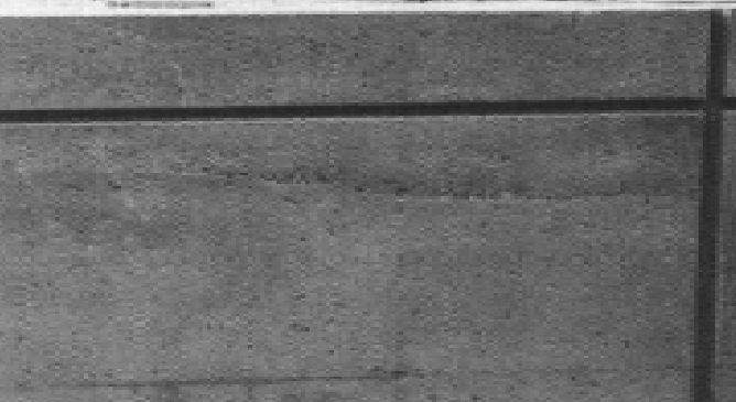

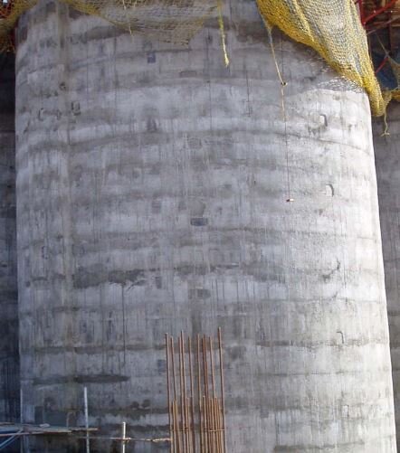

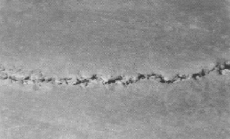

Layer lines
Layer lines are dark horizontal lines on formed surfaces which indicate the boundary between concrete placements. Layer lines are caused by stiffening or insufficient consolidation of the lower level due to lack of penetration of the vibrator into the lower level.

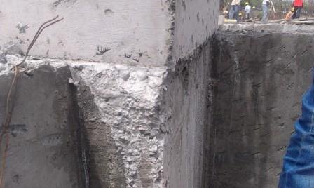

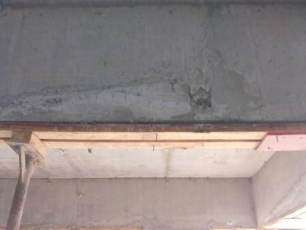

Cold joints
Cold joints frequently occur in concrete for many reasons. Cold joints can often be avoided by contingency planning, back-up equipment, working to keep the concrete surface alive, and working to vibrate into lower lifts.

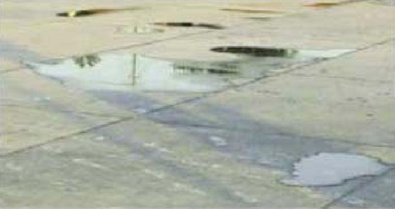

Bird Bath
Its a minor defect in concrete surface cause by not leveling surface correctly.
