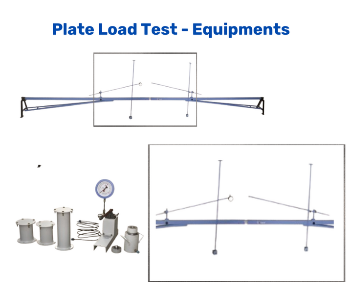

Equipment Used in Plate Load Test​
  • Mild Steel Plate: 300 mm to 750 mm diameter, usually circular and 25 mm thick.
  • Hydraulic Jack: for applying the load on the plate.
  • Reaction Frame or Load Platform: Normally a truck or heavy beam to provide counterweight.
  • Dial Gauges: Settlement of the plate at every load increment is measured.
  • Pressure Gauge: For the measurement of applied load pressure.

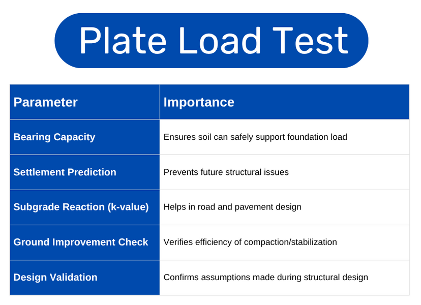

Importance of Plate Load Test in Geotechnical Engineering​
  • Determines Safe Bearing Capacity : This helps in choosing the correct type and size of foundation to ensure structural safety.
  • Predicts Settlement Behaviour : It provides the correct data on how much the foundation will settle over time under an applied load.
  • Validates Design Assumptions : It confirms the actual site soil conditions against theoretical design data.
  • Ground Improvement Assessment : It serves to check the improvement in load-bearing performance after soil stabilization or compaction.
  • Fundamental to Pavement Design : Determines the k-value-modulus of subgrade reaction, important in rigid pavement and runway design.
  • Provides Real Field Data : Unlike lab tests, PLT directly reflects in-situ soil performance and gives a realistic picture of how the ground behaves under load.
