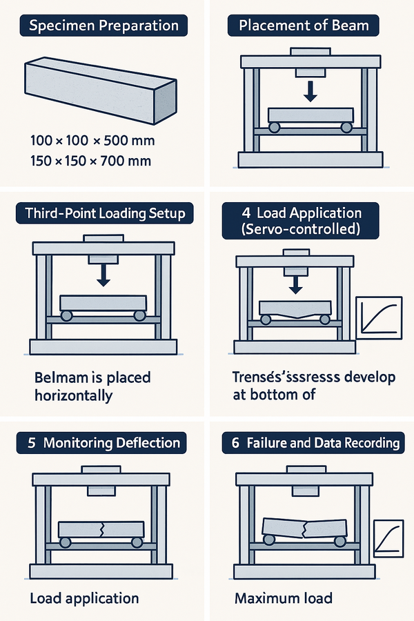

Step-by-Step Working Procedure of Flexure Testing Machine​
Step 1: Specimen Preparation​
Concrete beam specimens are cast according to standard dimensions:
  • 100 × 100 × 500 mm
  • 150 × 150 × 700 mm
The specimens are cured properly as per the relevant standard before testing.
Step 2: Placement of Beam​
The beam is placed horizontally on two lower support rollers inside the machine. Proper alignment is ensured so that the beam is centered and stable.
Step 3: Third-Point Loading Setup​
Two loading points are positioned at one-third distances from each support. This ensures uniform bending stress distribution in the central zone of the beam.
Step 4: Load Application (Servo-Controlled)​
The hydraulic actuator applies load gradually through the servo control system. Since the system operates in a closed-loop configuration, it maintains precise loading rates as per ASTM or IS standards.
Step 5: Monitoring Deflection​
As the load increases:
  • The beam begins to bend.
  • Tensile stresses develop at the bottom.
  • Cracks initiate at the mid-span.
The machine records real-time load and deflection data, producing a detailed load-deflection curve.
Step 6: Failure and Data Recording​
The test continues until:
  • Maximum load is reached.
  • The beam fails.
For FRC beams, even after cracking, fibers bridge the crack, allowing the beam to carry additional load. The machine captures this post-crack behavior, which is crucial under ASTM C1609.
