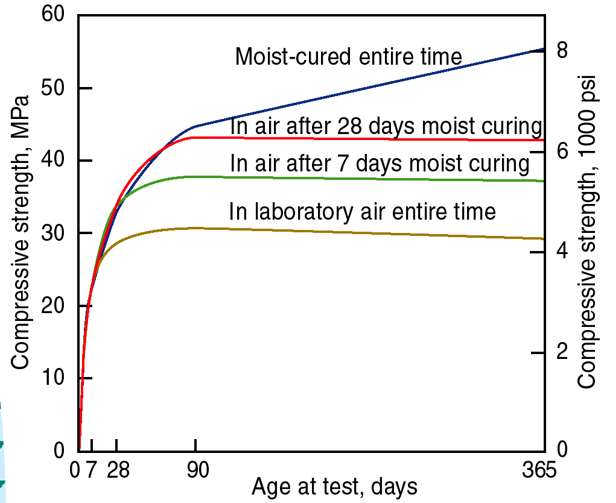

Effect of moist curing on strength of the concrete

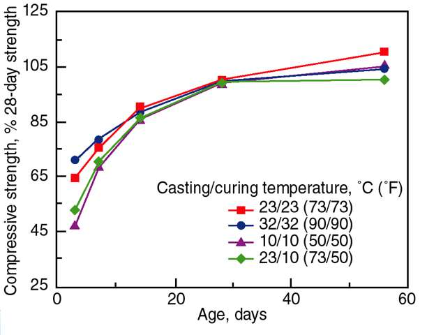

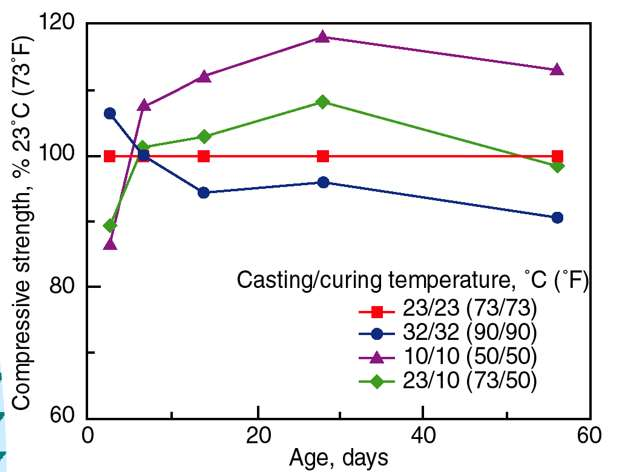

Effect of curing temperature on strength of the concrete
Impact of curing temperature on strength of concrete
