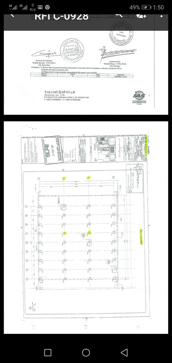

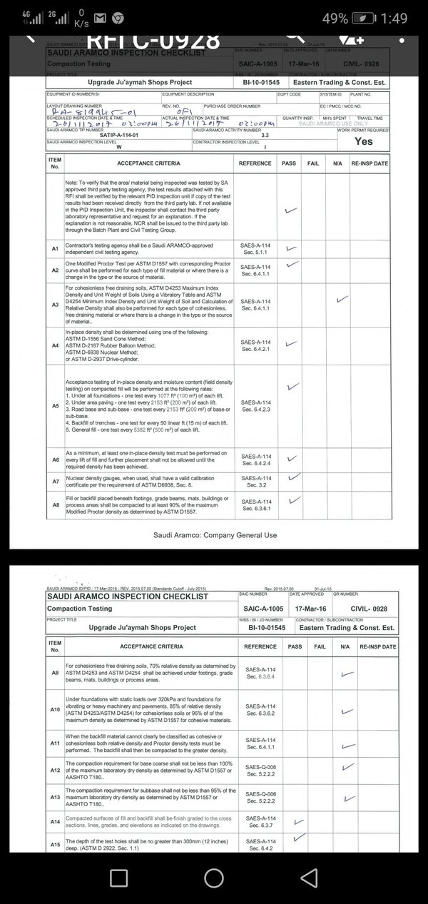

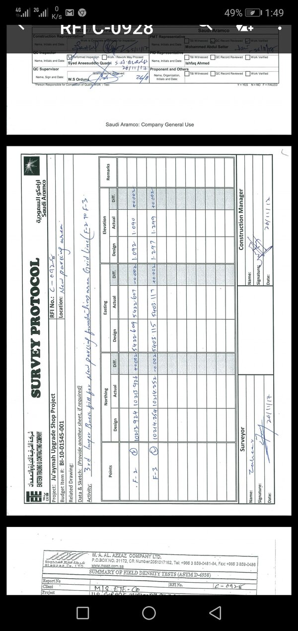

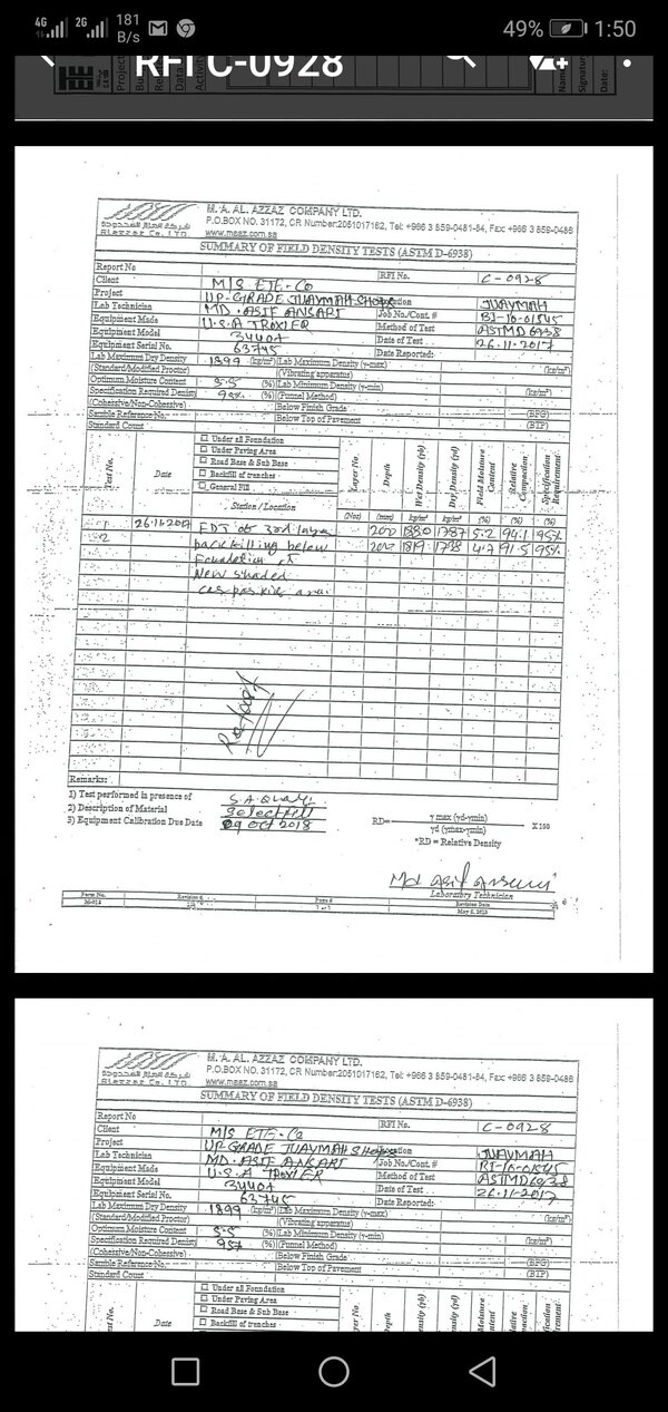

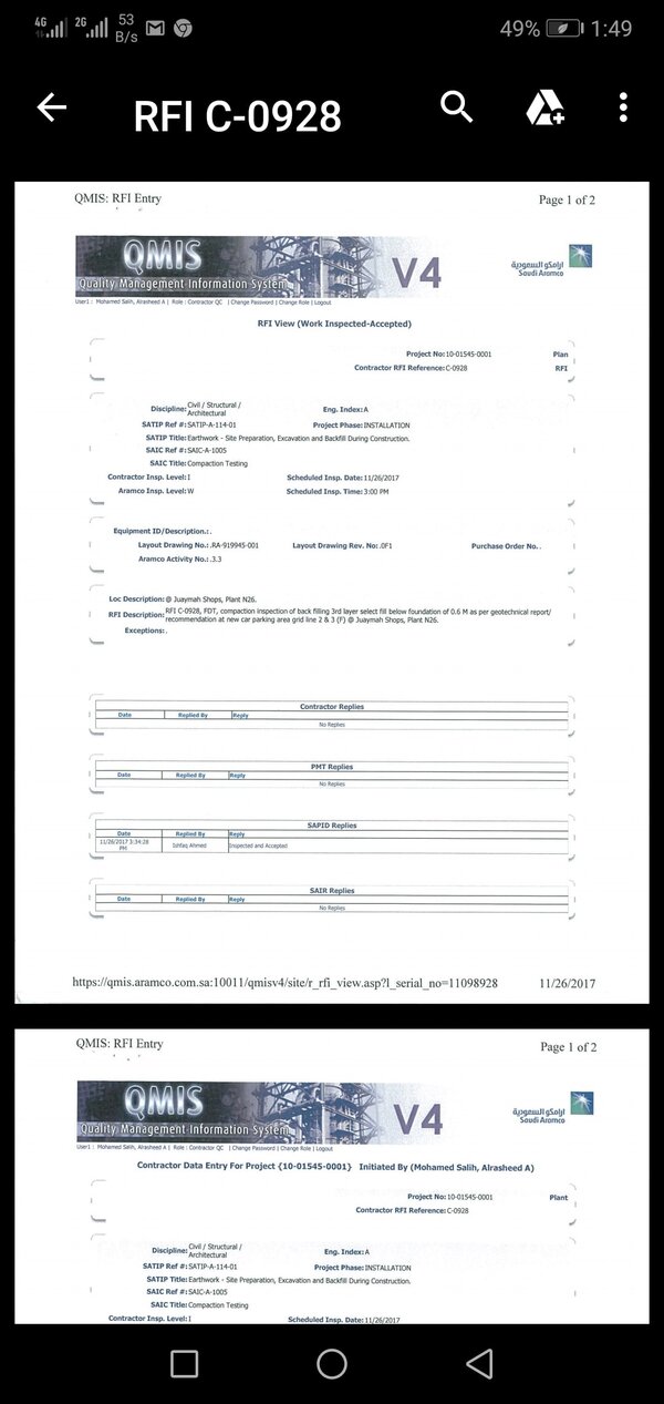

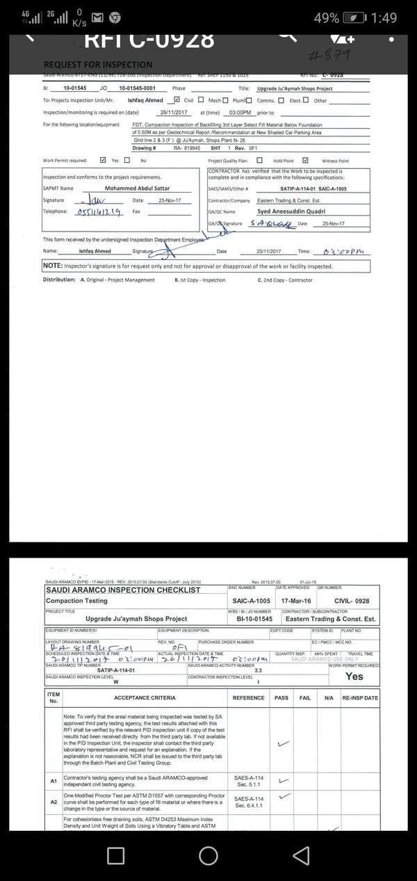

RFI=Request for inspection
Its mean when your any Specific Activity is complete for inspection than you will send the RFI to your client or their designated representative direct or through the PMT.
Which the following documents
1.QMIS page
2.RFI page
3.Chacklists
4.Drawings (Related to the specific job)
5.Lab Report (IF REQUUIRED)
