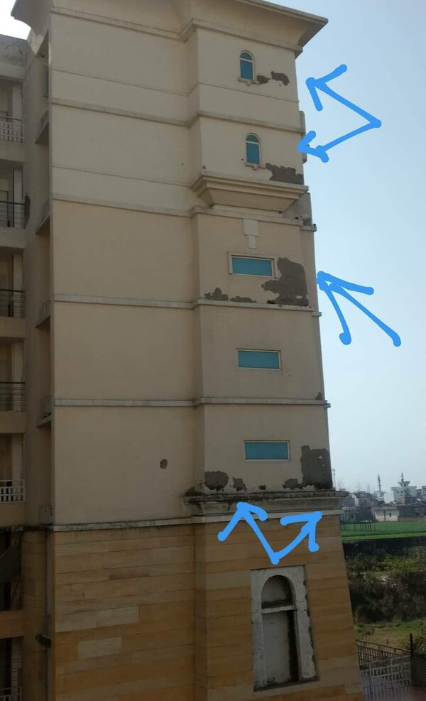

What is the reason behind such damages on plaster surface?
rames.psg
Junior Member
I may be wrong
Anyway want to try
Peeling of plastered surface due to weather condition alternate wet and dry condition
Treatment would be prepare the surface with chicken mesh and apply rough plaster water proofing compound also can be applied then plaster the wall
Next step would be apply external putty and do primer and final coats
Please correct if I am wrong
AjitA
Newbie
Details about building not given.
May be due Plumbing issues if there is toilet at that location.
The defect in plumbing system and then suitable waterproofing can work
