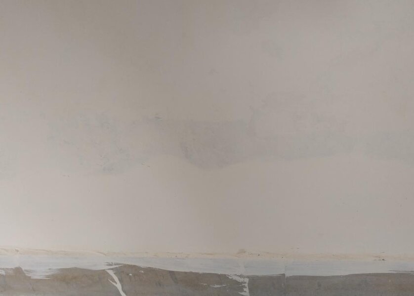

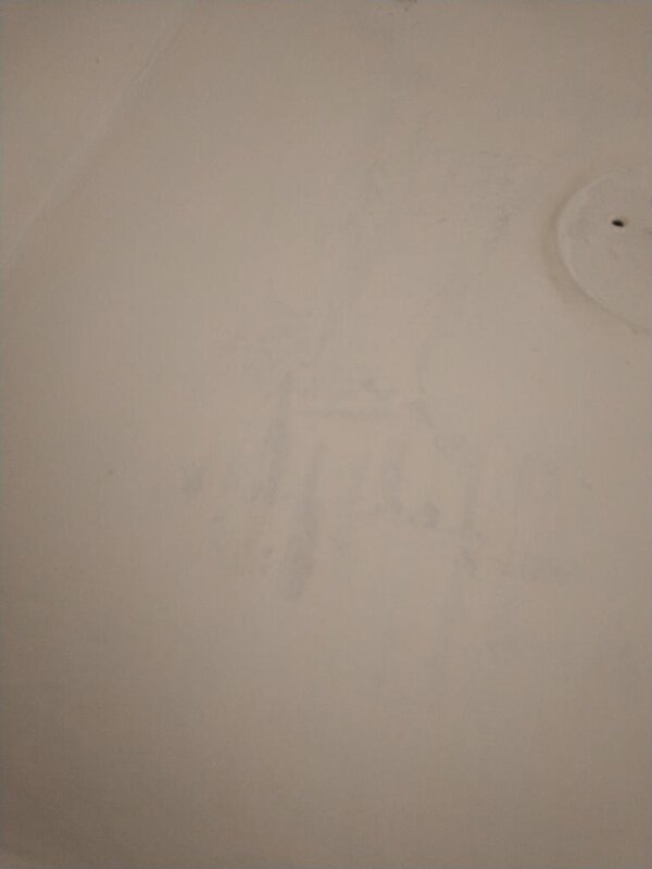

what is the reason for black patches and there is blistering in wall?
Black patches on wall are due to absorption of the paint by the wall surface.
to ensure uniform paint and colour tone on walls and ceiling, a primer coat is applied on wall surface, which improves the bonding of paint with wall surface without allowing it to getting absorbed and gives a consistent tone.
