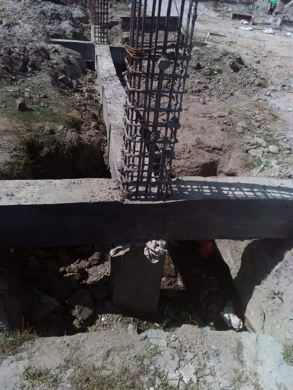

looks all good other than curing of concrete.
there is empty cement bag stuck in concrete at plinth beam and column joint. we should not use such material to seal the gap between shutter.
It also indicates (might be) the plinth beam had de-shutter on second day and this snap is taken.
in that case, there is no bottom support seen to plinth beam near column area.
if the curing of the concrete not done correctly, it will lead to make concrete weaker.
