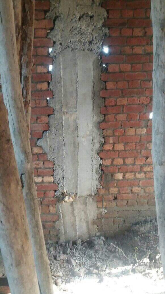

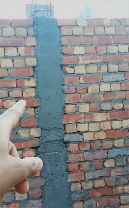

No, this is not a Good Engineering Practice. The Moisture in the Concrete will be absorbed by the Bricks and concrete gets de-hydrated, thus loosing the strength. Also the form work will not be foolproof, thus the slurry leaks during the vibration of concrete.
