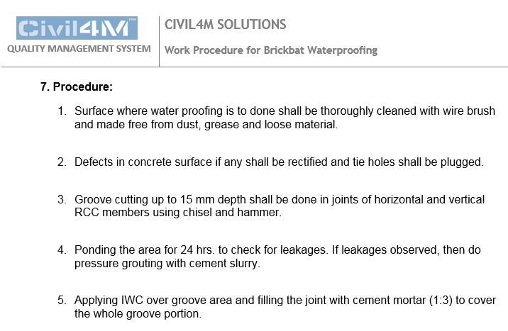

7. Procedure:
Surface where water proofing is to done shall be thoroughly cleaned with wire brush and made free from dust, grease and loose material.
Defects in concrete surface if any shall be rectified and tie holes shall be plugged.
Groove cutting up to 15 mm depth shall be done in joints of horizontal and vertical RCC members using chisel and hammer.
Ponding the area for 24 hrs. to check for leakages. If leakages observed, then do pressure grouting with cement slurry.
Applying IWC over groove area and filling the joint with cement mortar (1:3) to cover the whole groove portion.
Ponding test should be done for 24 hrs. to check for leakages.
Application of base coat on floor and wall portion covering up to height of 1.2 m above sunk. (IWC is used with 1:3 CM @ 100 to 150 ml / bag of cement).
Ponding test for 3 days (If ponding test fails remove and re-do the entire base coat).
Construction of ledge wall where required and curing for 3 days.
There after complete plumbing works for ledge wall in toilet portion and after testing encase the plumbing lines.
Brick bat coba with cement mortar (1:3) and required slope towards drain traps pipes.
Carrying out IPS according to slope with (1:4) CM and IWC @100 to 150 ml / bag of cement.
Curing for next 7 days by ponding.
