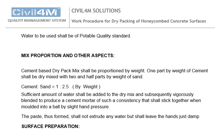

Ingredients of cement based Dry pack mix are Cement, Sand and Water.
Site tested Ordinary Portland Cement conforming to IS: 1489 / 12269 shall be used. Cement shall be PPC / OPC 53 Grade.
Sand fraction passing 1.18 mm IS sieve and retained over 150 micron IS sieve and kept in dry condition shall be used for the mix.
Water to be used shall be of Potable Quality standard.
MIX PROPORTION AND OTHER ASPECTS:
Cement based Dry Pack Mix shall be proportioned by weight. One part by weight of Cement shall be dry mixed with two and half parts by weight of sand.
Cement: Sand = 1 : 2.5 ( By Weight )
Sufficient amount of water shall be added to the dry mix and subsequently vigorously blended to produce a cement mortar of such a consistency that shall stick together when moulded into a ball by slight hand pressure.
The paste, thus formed, shall not extrude any water but shall leave the hands just damp.
