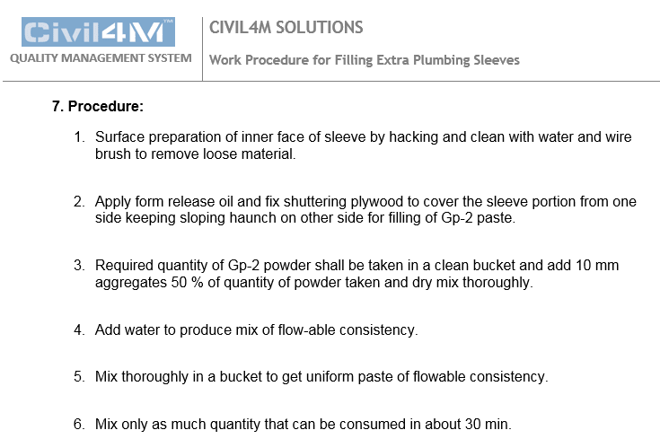

7. Procedure:
Surface preparation of inner face of sleeve by hacking and clean with water and wire brush to remove loose material.
Apply form release oil and fix shuttering plywood to cover the sleeve portion from one side keeping sloping haunch on other side for filling of Gp-2 paste.
Required quantity of Gp-2 powder shall be taken in a clean bucket and add 10 mm aggregates 50 % of quantity of powder taken and dry mix thoroughly.
Add water to produce mix of flow-able consistency.
Mix thoroughly in a bucket to get uniform paste of flowable consistency.
Mix only as much quantity that can be consumed in about 30 min.
Flowable paste prepared shall be poured through sloping haunch shutter filling the entire sleeve using manual compaction.
De-shuttering shall be done after 24 hrs. and excess paste in haunch portion if any shall be finished off to match the surface.
Curing for next 3 days by wrapping with wet hessian cloth.
