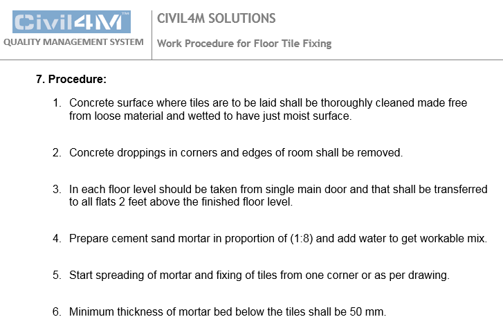

7. Procedure:
Concrete surface where tiles are to be laid shall be thoroughly cleaned made free from loose material and wetted to have just moist surface.
Concrete droppings in corners and edges of room shall be removed.
In each floor level should be taken from single main door and that shall be transferred to all flats 2 feet above the finished floor level.
Prepare cement sand mortar in proportion of (1:8) and add water to get workable mix.
Start spreading of mortar and fixing of tiles from one corner or as per drawing.
Minimum thickness of mortar bed below the tiles shall be 50 mm.
Using wooden mallet fix the tiles by tamping on all four corners.
Skirting shall be fixed after 24 hrs. using same tiles and joints in skirting and flooring shall be matched.
Joints in between tiles shall be filled using white cement paste.
Joints curing shall be done by sprinkling water or using wet hessian cloth.
