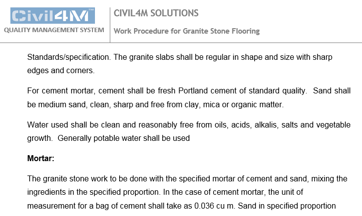

The sample of granite slabs shall be of 20 mm thick steel gray color of size1000 mm x 1000 mm free from cracks, fissures & flakes with straight edges & perfect corners at right angles finished (honed finish/sand blaster finish) shall be supplied as per the approved specification and drawings and got it approved before starting the work. Physical requirements, quality, dimensions, tolerances etc. of granite stone shall conform to the Indian Standards/specification. The granite slabs shall be regular in shape and size with sharp edges and corners.
For cement mortar, cement shall be fresh Portland cement of standard quality. Sand shall be medium sand, clean, sharp and free from clay, mica or organic matter.
Water used shall be clean and reasonably free from oils, acids, alkalis, salts and vegetable growth. Generally potable water shall be used
Mortar:
The granite stone work to be done with the specified mortar of cement and sand, mixing the ingredients in the specified proportion. In the case of cement mortar, the unit of measurement for a bag of cement shall take as 0.036 cu m. Sand in specified proportion shall be measured in boxes of suitable size 30 cm x 30 cm x 40 cm. Sand shall be measured on the basis of its dry volume. In case of damp sand, its quantity shall be increased suitably to allow for bulkage. Materials of mortar shall be first mixed dry till of uniform color on a solid clean watertight platform and then mixed wet by adding water gradually and evenly to have a workable consistency of a stiff paste. Only the quantity of cement mortar, which can be used within 30 minutes to be prepared at a time.
Mortar:
