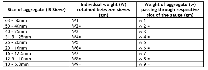

Observation table (As per the clause 4.5 & table V of IS 2386 – part I)
