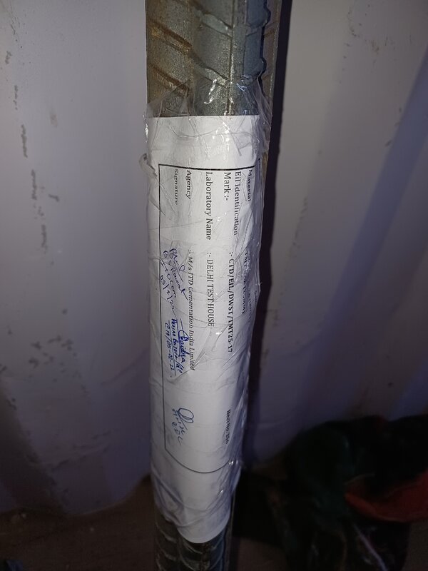

Whenever materials reaches at site it is to be verified by manually & check MTC in presence of Clients, after checking manually sampling for third party testing to be done and send the sample to thrid party testing Laboratory. After getting it’s original Test report from 3rd party lab it is to be submitted with IMIR and Close it.
