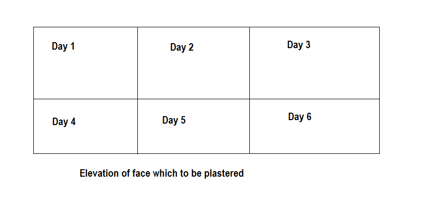

The plaster should be always done in panels of vertical height. i.e.- you can calculate the coverage area as per the team of plastering you have and make a vertical panels design in which plaster starts from top and ends at bottom. in case the building height is more you can make horizontal panels too with vertical.
You can either make level pads or simply put a line thread from top to bottom for making plaster in line.
Below image shows planning of plastering as per panel.
If the height of building is more and cant be covered in a day, the planning of plastering activity should be done as shown.
This ensures the curing of plaster and minimization of joints in plaster.
