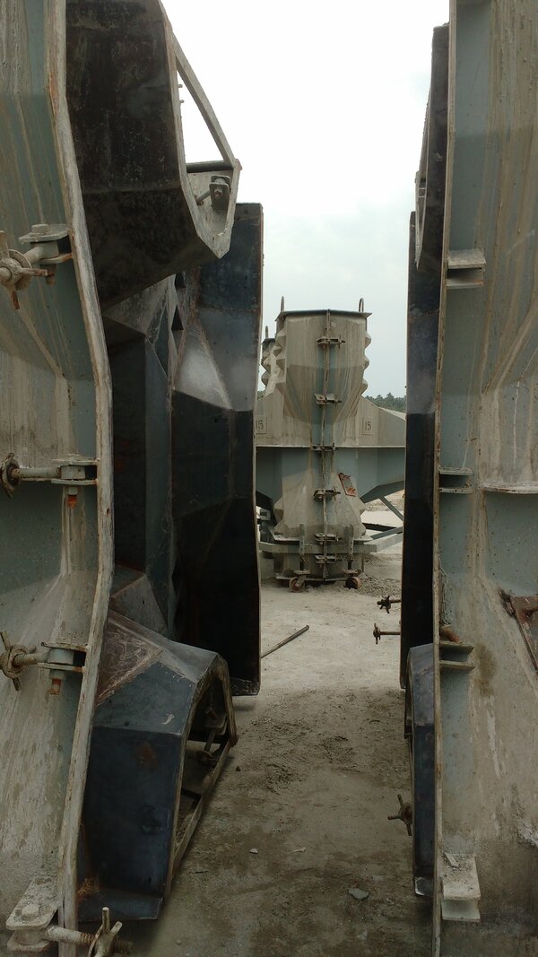

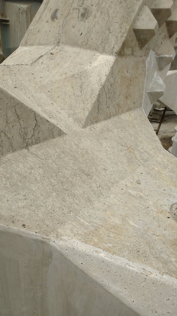

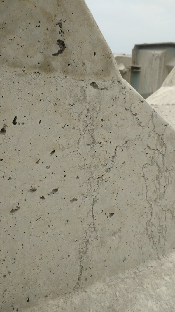

I am working in accropode-// project in vizhinzam port , kerala.we are using steel frame for concreting . after casting we are face shrinkage crack and air voids . How we overcome from this problem.that can minimise the cracks. Although we are using surface vibrator and hammering.
Over vibration can cause the fine materials to get accumulate at surface and near to form face.
If overvibrated, fines on surface will going to call for shrinkage.
As from picture and shape it look like max structure area have form finish, overvibration cant be seen.

It may be formation of bleed channels due to over vibration. and surface voids that resulted from the migration of entrapped air (and to a lesser extent water) to the fresh concrete-form interface.

I have inspected the images provided by you.
Your Formwork / mould quality is good, its water tight form.
Your concrete have the more water content, extra water is trying to escape out from the concrete surface, but due to water tight formwork. it is occupying the space on surface of concrete which is causing defect.
Airation might be problem with your Admixture (Admixture compatibility to be check with all brands of cement you use), Had you change the brand of cement or admixture.

I see hardly any shrinkage cracks on surface of concrete - You are taking good care of concrete.

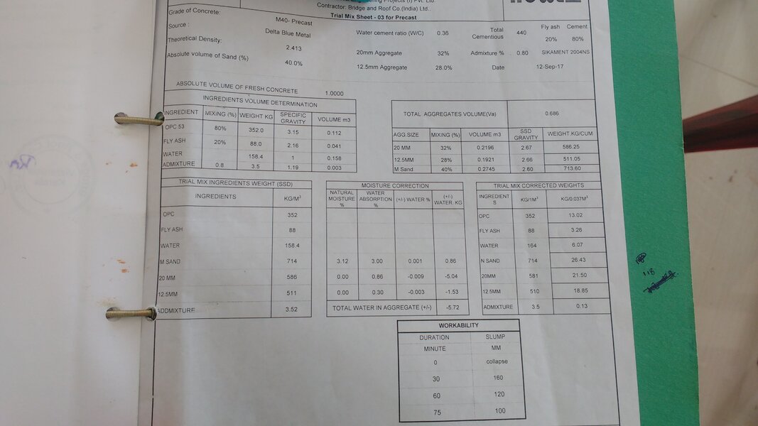

Is concrete produce with your mix design gives volume of 1 cum exactly.
If its design by you, cross check the specific gravities of all aggregates (Though you are using 40% FA, it might be more compare to volume, if SG is not calculated properly)

As mentioned above @Dnyan Deshmukh kindly check for mix design calculation sheet , as per attached sheet density of concrete is below 2400kg/cum.
please recheck aggregate grading part, correction can be done accordingly. Enough fine particle available in your concrete, you can think off increasing the 20mm aggregate
