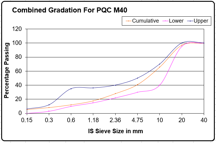

combine gradation

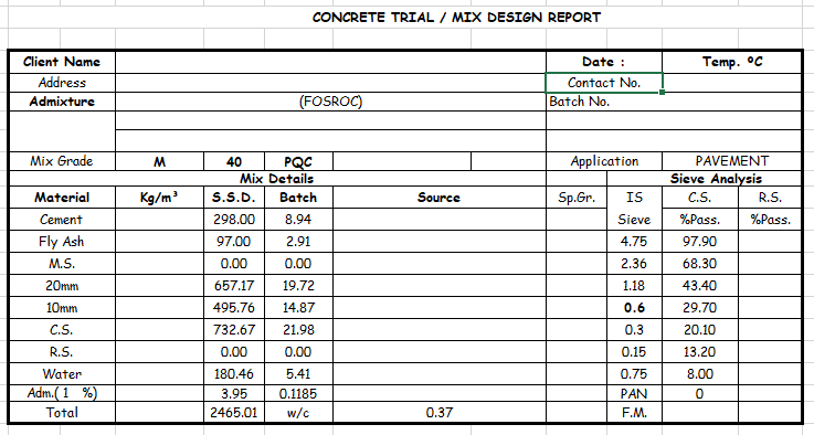

Concrete mix design report (after doing calculations on input, report is generated as below)

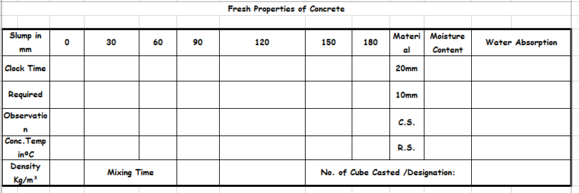

it also have the format for doing test on fresh concrete.

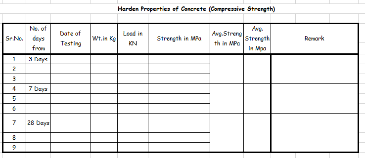

and also for harden concrete properties testing.

combine gradation
