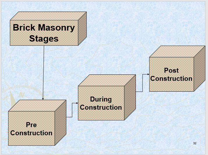

Stages in Brick masonry work activity

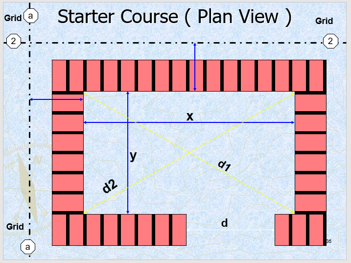

Base course in brick masonry

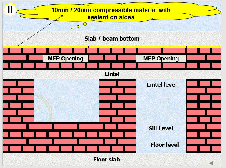

Brick masonry work details

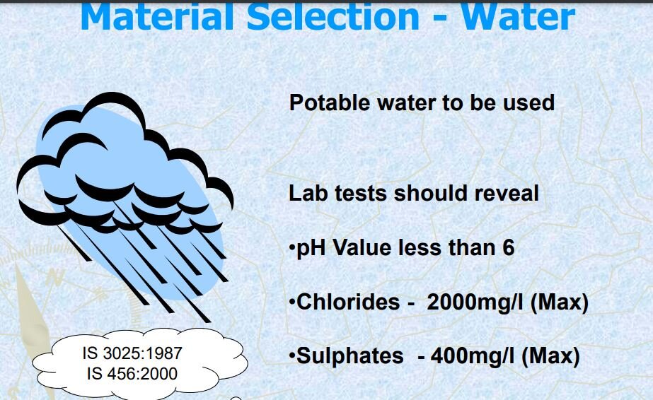

sir i saw your presentation very nice but i have a question in the water selection .here i attached the presentation picture ,in this picture PH VALUE LESS THEN 6 IS MENTIONED .if less than 6 means its acidic so it wil react with cement and sand composition right or wrong? if right means here for morter preparation not less than 6 (PH VALUE) and not greater than 8 .
