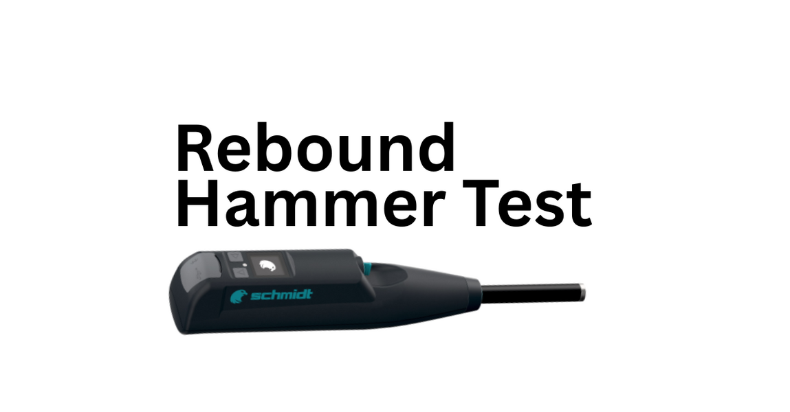

Also called the Schmidt Hammer Test, this is a portable, non-destructive method to check the surface hardness. This test works by striking the concrete with a spring-loaded mass, and by measuring the amount of energy that "rebounds" back.
This Rebound Number serves as an indirect representation of its compressive strength. Engineers worldwide prefer the test because:
