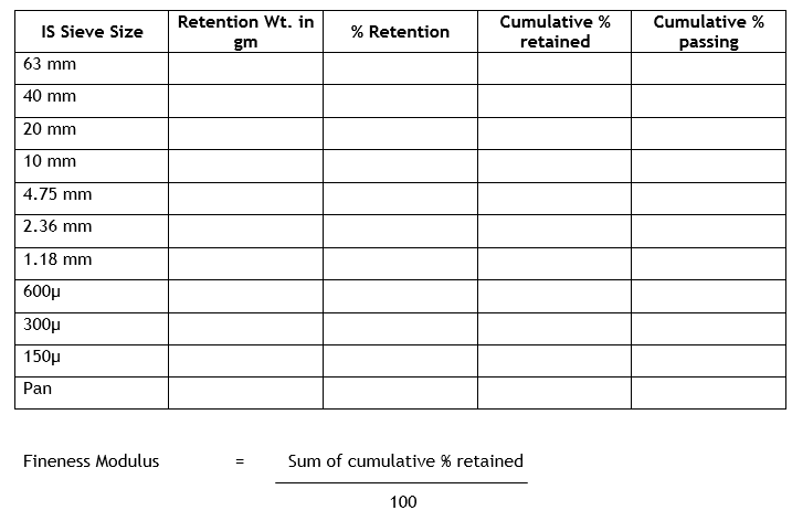

A typical format for tabulating the results is given below:
