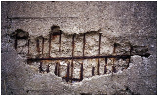

Clear Cover Of Column, Beam and Slab :-
Clear Cover means the clear distance between the exterior face of the reinforcements towards the nearest surface of the RCC Section and the exterior face of that section. In most of the general cases the values of clear cover are 50mm for Foundation, 40mm for Column, 25mm for Beam, 15mm for Slab and Stair.
Now I’ve seen In most cases that people tend to ignore this cover value about weather it is maintained correctly or not, in cases I found that there may be unequal cover provided on column sides like in one side mason has given 20mm cover and on the other side it is 75mm. This occurs mainly due to the not properly using Cover Blocks for maintain the cover. In case of Beam, Slab the same thing occurs, the mason either may have increased the cover or may have decreased the value than what is actually to be provided. In either way it’s harmful and may bring catastrophic results.
EFFECT OF MOISTURE PENETRATION
As a result of the of the above the consequence will follow like this way, if we provide insufficient cover then after 5-15 years later depending upon the exposure the insufficient cover will be easily penetrated by the moisture as the cover is insufficient to resist the penetration and also due to the fact that if cover is too little then the concrete cover at the face of reinforcement will be so thin that it will have a tendency to crack and hence will ease the entrance of moisture, which in turn will corrode the reinforcement then the structure will lose it’s capacity of taking loads as rusting in the Steel is made of loose particles hence the Bond between the steel and the concrete will be totally lost, and will cause a failure of the structure under the Load. If the cover is increased than what has been specified by the Designing sheets then there will lie a huge risk of flexural failure of the structure due to the fact if the cover is increased then it means the effective depth of the structure will be decreased also, due to this decrease in the effective depth in the section, the Moment of Resistance of the section will get reduced drastically even with a small increase in the cover than what is specified. Therefore the structure will not be capable of taking up the Designed Bending Moment. So we now see that the ignorance of the cover must be avoided, and the specified cover in the designing sheet must be strictly followed to.

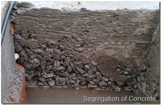

Free Fall Of Concrete :-
Concrete is the conglomeration of Binding Material (Cement), Fine Aggregate (Sand), Coarse Aggregate (Stone Chips) with right proportion of water based on the Water-Cement Ratio. As the Specific Gravity of different ingredients of concrete varies hence when concrete is dropped at the time of placing of concrete the different ingredients tends to fall at different rate under the action of Gravitational Pull. Therefore all the ingredients has a tendency to get separated from each other, but if the fall of concrete is not from much height then these ingredients does not get separated from each other due to the binding of cement paste. But if the Concrete is dropped from a greater height then the cement paste fails to hold them as a homogeneous mixture and all the ingredients separates and gets deposited in layers according to their specific gravity, hence the Stone Chips silts at the bottom, then over it sand silts then over it cement slurry of the greater portion.
CONCRETE SEGREGATION
This phenomenon is known as the Segregation of Concrete. Therefore in this case the concrete does not remains actually concrete, and losses almost its all properties and strength, and such a structure collapses under Design Load. This can be prevented by dropping the concrete from a maximum height of 1.5m. I’ve seen in casting of column, many people are casting the full length of column at a time, which means a full length of column say about 2.7m is being caste at a time, hence the concrete dropping from the top is falling through a height of more than 1.5m, as a result segregation takes place at the bottom of the column, and the whole column becomes unstable under the loads and have greater chance of collapsing. And one more thing, Patching up the segregated column with Rich Mortar say of proportion 1:3 will not cure it, this patch will only hide the Scar beneath. Only cure is to dismantle the column and reconstructing it.

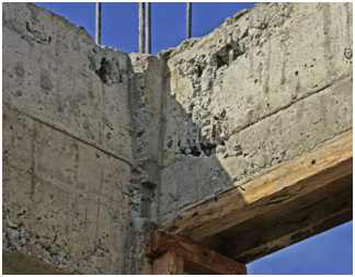

Improper Compaction :-
Compaction is a very essential process in concreting practice. Proper compaction makes a concrete dense, and hence the harden concrete results in having greater density which in turn gives higher durability to the concrete, making it impervious to moisture and other harmful chemicals. As the density increases with good quality compaction hence it gives greater strength, and also the honeycombing can be avoided.
HONEY COMBING DUE TO BAD COMPACTION
If Compaction is not good then durability of the concrete will be reduced and also strength will be reduced. Improper Compaction causes air voids in the concrete which reduces the strength of the concrete. Only About 5% Voids can reduce the strength of the concrete up to 30%. Hence this becomes very necessary to do proper compaction to the concrete. The Concrete in Beam, Lintel and in other type of section where Depth is 150mm or more in those cases Concrete should be placed in layer and after compaction of a layer the next layer should be laid and the compaction should be done and then the next layer and compaction again so as to achieve a Compact and Homogeneous Concrete.
