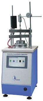

aimil's Consolidation testing apparatus​
