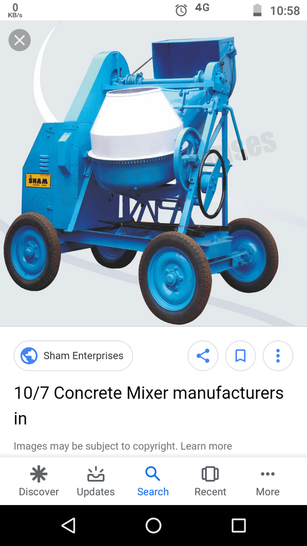

Sir it doesn't look like drum is soo big that it mixes 7cum of concrete
I guess u understood wat I'm trying to say plz do comment thanks

  1. 10/7 Mixer is generally referred to Spot Drum Type Mixers and not Transit Mixers.
  2. 10/7 means the Input dry volume = 10 cu ft. and Output wet volume = 7 cu. ft.
  3. This is an old terminology which is still in vogue.
  4. In modern terminology, as per IS 1791 the same is known as NT (or T or R) 200.
