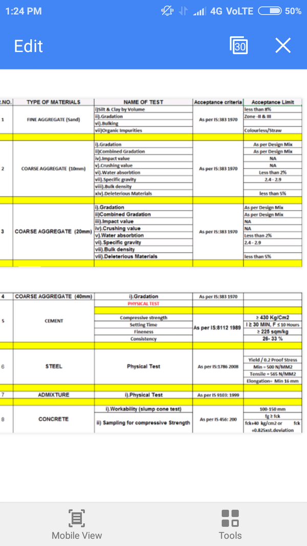

So its up to you, for selecting a criteria for acceptance and making a "Inspection and Test Plan(ITP).
Materials like aggregates are produced at crusher and mostly by local people who do not have much concern of Quality.
Such materials should be checked in each lot received for a specific parameters like Size and gradation, Quality of rock - is it basalt or just crush a soft rock.
Material which have more control on manufacturing side needs less testing frequency but you can check basic parameters on receiving each lot.
i will share a sample ITP soon, so that you can make your own by referring it.
