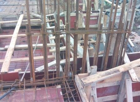

Now i know what cover to be provided to reinforcement bars, when a structure is actually getting built, are we serious about the intensity of what happens when there is less cover than the specified, is i am reducing the life of structure? or we just so ignorant that we make it as a its OK to have less cover.
Here we fail to understand the structural designers point of view on having cover to reinforcement bars, this will inordinately going to lead in reduction of durability and by the time we may or may not be on this earth to see its refercations. So after understanding it, i Hope every Civil Engineer will give importance to give adequate cover to reinforcement bars.

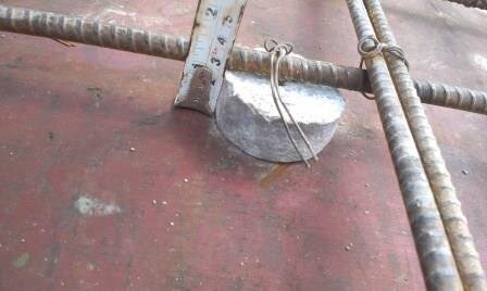

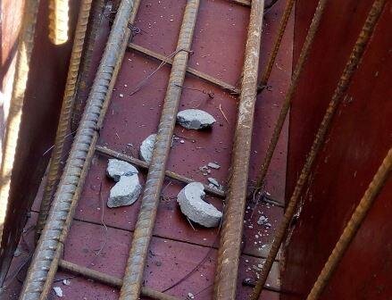

We should also check for the correct size of the cover blocks used for doing construction of the project.
Cover block should be of same strength as of concrete which is being poured in structure, using weaker cover blocks will also lead to healthy and faster attacks on reinforcement bars which will reduce the durability of structure.
It is now trend to use PVC cover block due to its cheaper price but we should also think from the durability point of view to use those PVC cover Blocks or not. PVC never stick to cement, over the time it will form a separation cracks and make access to reinforcement bars.

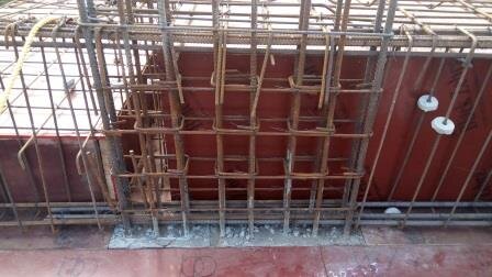

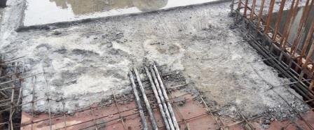

After doing concreting, it is important to do construction joint preparation to ensure good bonding between old and new concrete we pace in structure. if the lattice not removed from the concrete surface, it may lead to weaker bond in concrete.
The smooth surface at the top of the concrete could be cause due to over vibration or fine particle accumulation during process of compaction of the concrete. It is important to remove all those lattice from the top of the concrete. this can be achieved by various ways, such as using water jet, roughening the concrete surface by making aggregate exposed without dislodging or you can press the 20mm size aggregates halfway into top surface to form a mechanical key for bonding of the concrete.

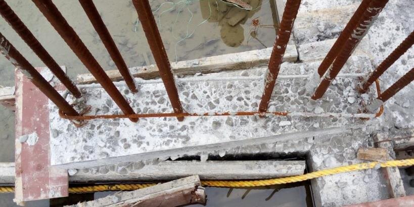

Same way construction joints in slab are also important and they are weaker sections in structure from where durability of the structure can get reduce. the joint should be made in a straight line and at locations as specified by the structural consultant only. it do happens that concrete get flowed beyond the stopper which was placed to arrest the concrete. in such cases all concrete which flowed beyond the stopper should be removed when its fresh or by breaking on very next day.

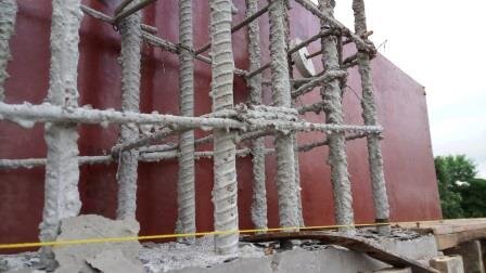

The bond between the concrete and reinforcement steel bar is very important part from durability point of view, during practical application, it is commonly observed that, some concrete do get stuck to reinforcement bars during concreting activity. it should be removed from steel bars to ensure proper bonding of concrete with reinforcement steel bars.
It is also observed that, during application of oil to shutters, some oil do also get spilled on slab and reinforcement bars get coated with it, we should no allow oiling of shutter on slab top once the reinforcement work is started. in case oil spillage observed over reinforcement bars, we should get it clean with detergent by washing.

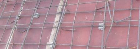

When it comes to top slab reinforcement bars, we often use rebar chair / ghodi and it do have many local names, there is a possibility that rebar chair is directly placed on shutter as the bar bender do think that it will give more stability to keep top reinforcement bars in place but it will have negative impact on durability of the structure, the rebar chairs should be always kept on bottom reinforcement bars of slab. for tying each lag of chair should be tied to 2 reinforcement bars of the slab which will ensure no toppling of chair during movement.

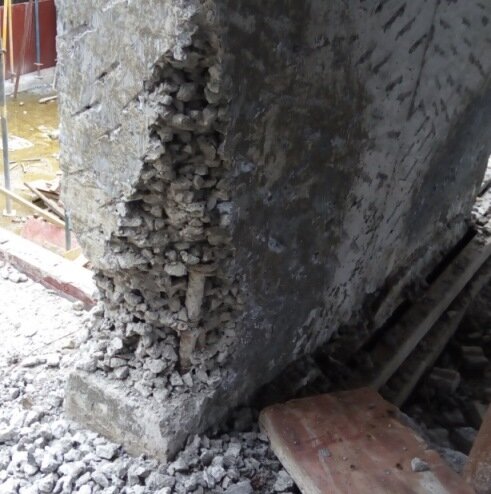

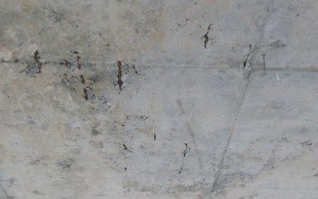

Low or inadequate cover to reinforcement bars lead to exposed reinforcement bars after concreting of structural members as the concrete does not pass due to low space. it can create another problem of honey combing too.
Honeycombing and exposed reinforcement bars in column do receive a patching with either cement paste or mortar or mortar with aggregate depending on the depth, in most of the cases those patching jobs are done by mason and mostly in hurry to ensure no one looks at it and make issue. also those patch wont get cure properly which can developes cracking and the source for reducing the durability of structure, if we do ensure proper covers are installed to reinforcement bars, those issues gets eliminated and durability of the structure is ensured.

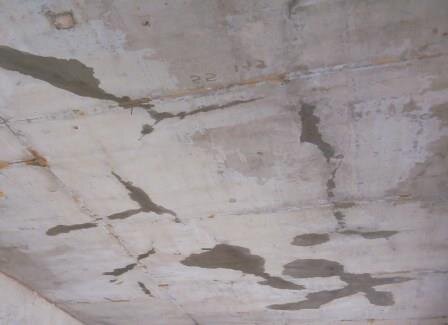

Exposed reinforcement bars can also be observed in slab bottom when the adequate cover to reinforcement bars are not installed.

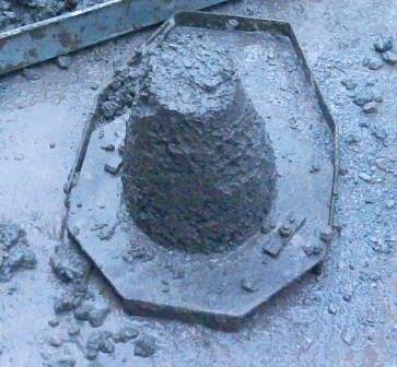

Exposure of reinforcement bars could also happen due to the workability of the concrete, if the concrete when received at site do lack in required amount, it will also create a problems of rebar exposure and honeycombing in structure due to no able to pass and reach each corner with efforts taken for doing compaction of concrete.
It is important to ensure the concrete does not lack in workability which is required to pour the concrete in structure. pressurizing the workforce to do the concrete pouring with concrete lacking in workability is not only asking for trouble but begging for it to come.

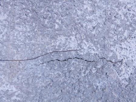

After placing of the concrete and finishing the surface to desired finishing details, it is very much important to start early curing on the concrete surface by sprinkling water and covering with hessian cloth or plastic sheets. else will lead to shrinkage cracking in the concrete, shrinkage cracks can also go through the whole thickness of structural member. shrinkage cracks creates the entry for mediums to do corrosion of reinforcement bars.
Those cracks will also take one of the medium which is water from top to down through it and make a permanent way for it which could actively do corrosion.
