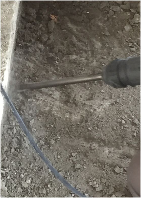

Chip out any access dead mortar from the surface of concrete.

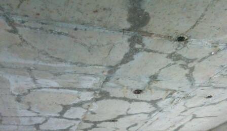

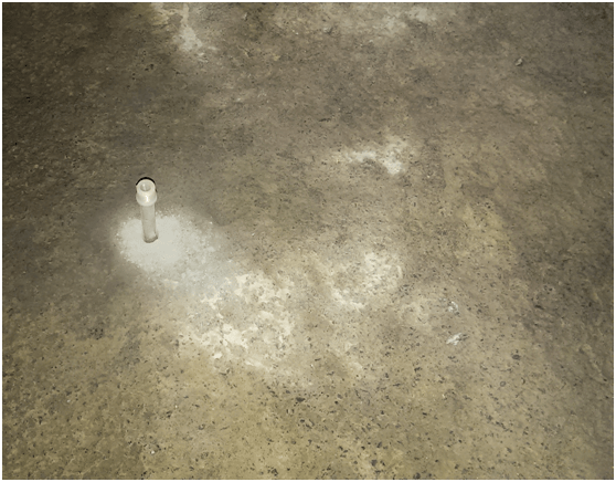

Open the cracks on surface from top by making 'V' groove, fill it with cement mortar including integral waterproofing compound and place the spouts in between.
In case dampness is seen, place the spout in weak areas.

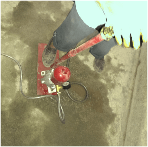

Do pressure grout it. You may grout it under gravity.

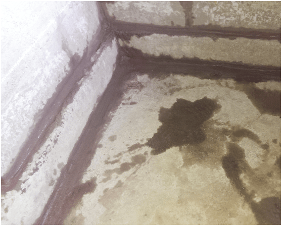

Fill the corners with angle fillet (slab to beam and beam to wall as applicable) and press 10mm metal on it.

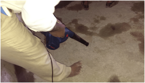

Before base coat do clean all surface to ensure bonding between surface and base coat.

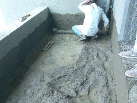

Do base coat as per approved material proportion and with approved integral water proofing compound in mix. do ensure slope towards spout if provided to drain of the water coming from top layer.

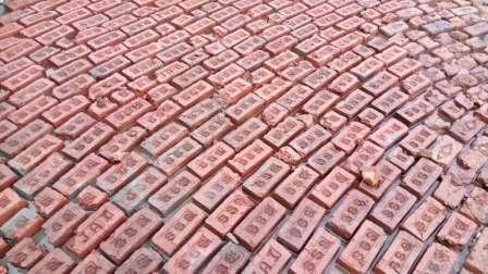

Then do brick bat layer by filling mortar halfway in brick bat thickness, to ensure top coat bonding.
