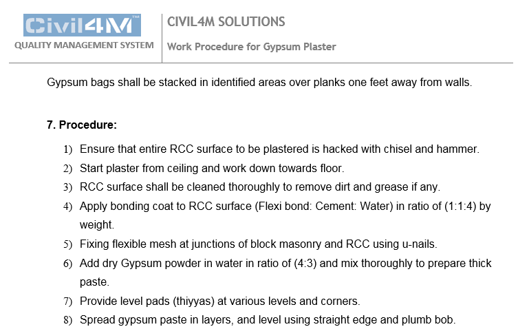

7. Procedure:
Ensure that entire RCC surface to be plastered is hacked with chisel and hammer.
Start plaster from ceiling and work down towards floor.
RCC surface shall be cleaned thoroughly to remove dirt and grease if any.
Apply bonding coat to RCC surface (Flexi bond : Cement : Water) in ratio of (1:1:4) by weight.
Fixing flexible mesh at junctions of block masonry and RCC using u-nails.
Add dry Gypsum powder in water in ratio of (4:3) and mix thoroughly to prepare thick paste.
Provide level pads (thiyyas) at various levels and corners.
Spread gypsum paste in layers, and level using straight edge and plumb bob.
Average thickness of plaster shall be kept 10 mm.
Lightly scour the surface with damp sponge and protect for next 3 hrs.
