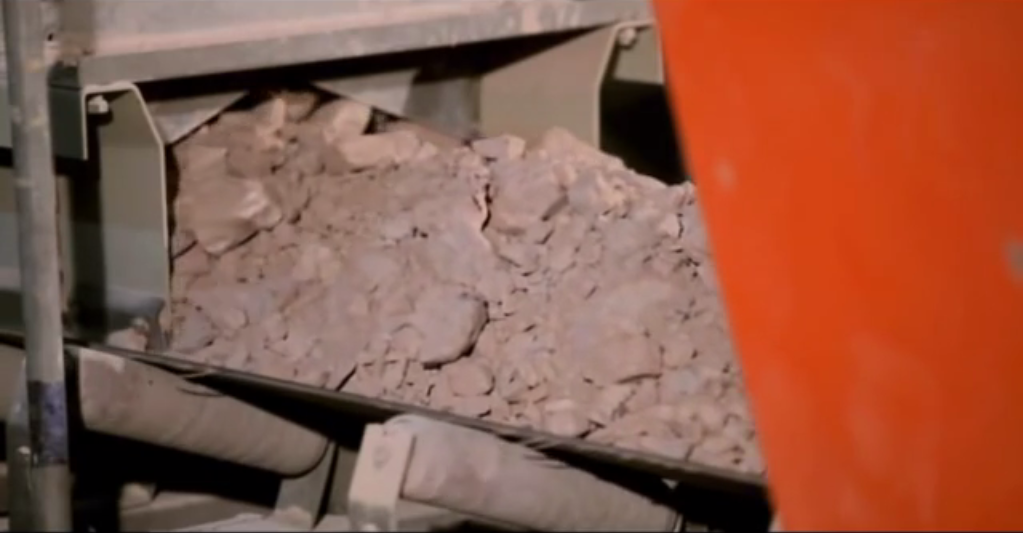

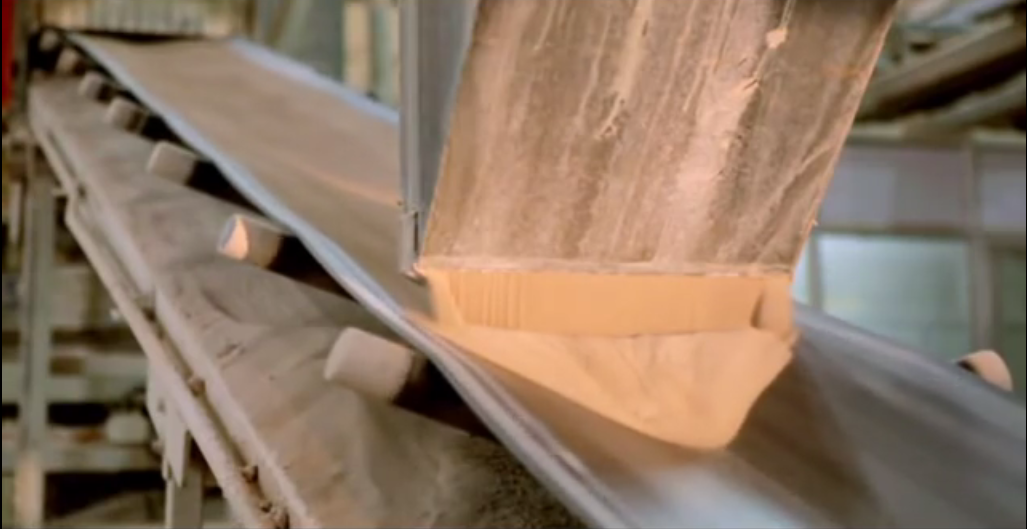

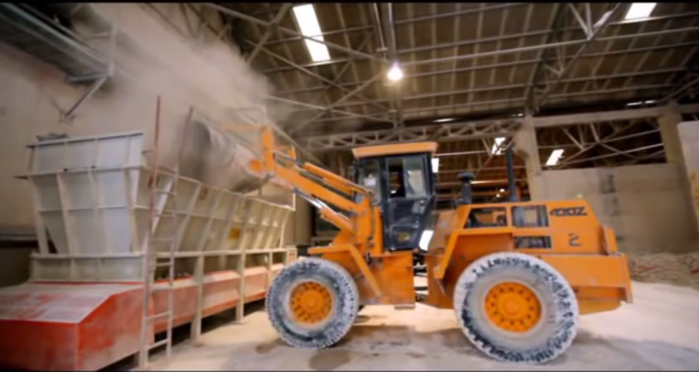

In the process of manufacturing of tile first the raw clay is loaded into the hoppers and blended with minerals in batch mixer homogeneously.

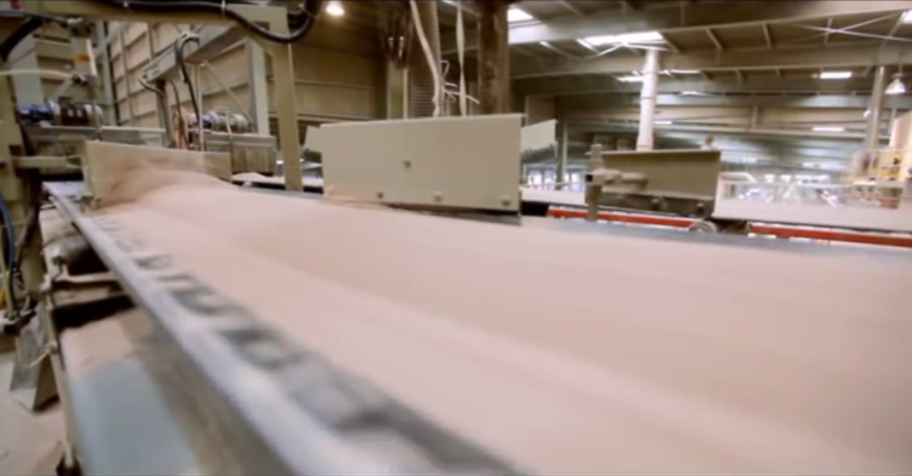

Those clay and minerals are sent via conveyor to a batch mixer to mix in proportion as specified by manufacturer to achieve the desired properties.

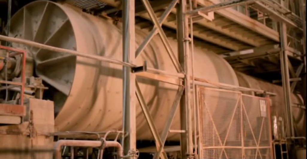

Then the blended mixture is sent to a ball mill and around 33% water by weight is added into it.

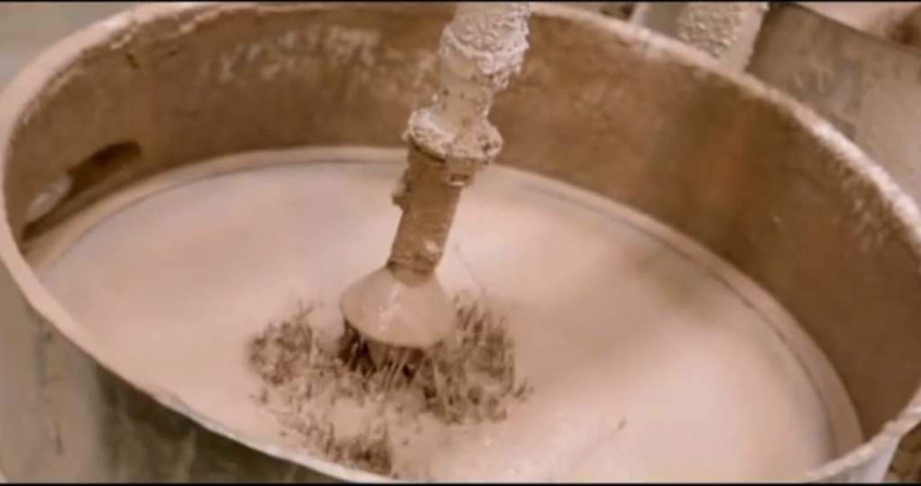

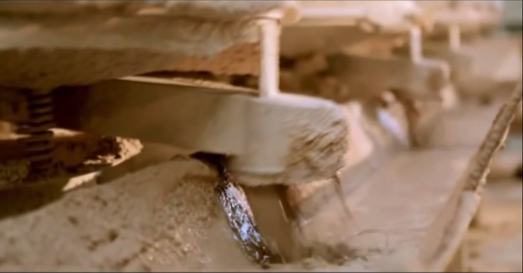

Ball mills content giant alumina balls which crush the clay into a finest slurry through a rotating action of ball mill and gravity force acting on alumina balls. Below is animated photo of milling action.
The milling action creates a homogeneous slurry which is taken out from ball mill and screened to remove the uncrushed clay or stones.

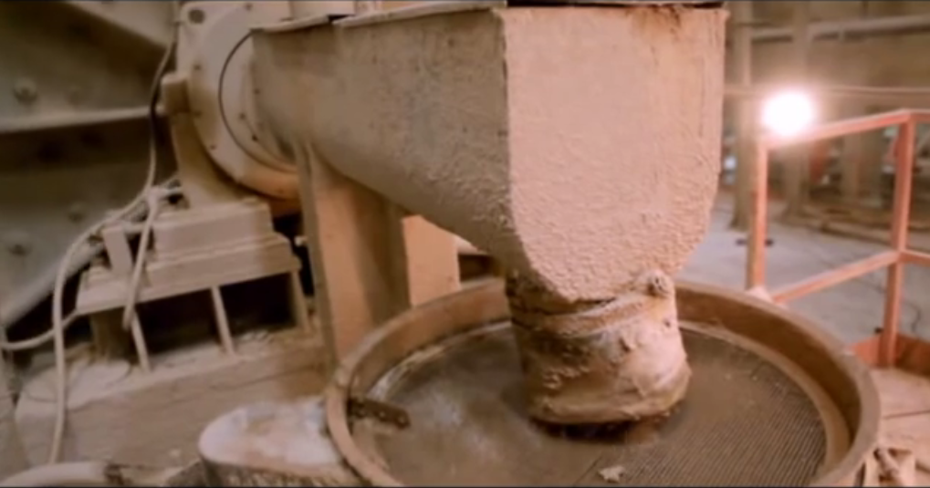

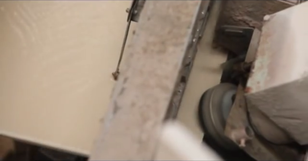

After passing through this hopper the slurry is further moved to a vibrating screens which have the mesh size of 75 microns. The vibrating actions ease out the process of making a fine slurry to pass through it and the oversized material to go out.

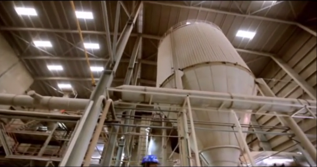

The spraying of slurry into a silo is done along with passing hot air into it. Spraying action and hot air pass makes the slurry to reduce its moisture from 33 to around 5 to 6 % which forms a finest granules of clay which are slightly moist. After formation of granules they are further moved to pressing machine which shape the tile body. The hot air pass and spraying of clay is done in control way to ensure the correct sizes of grains.

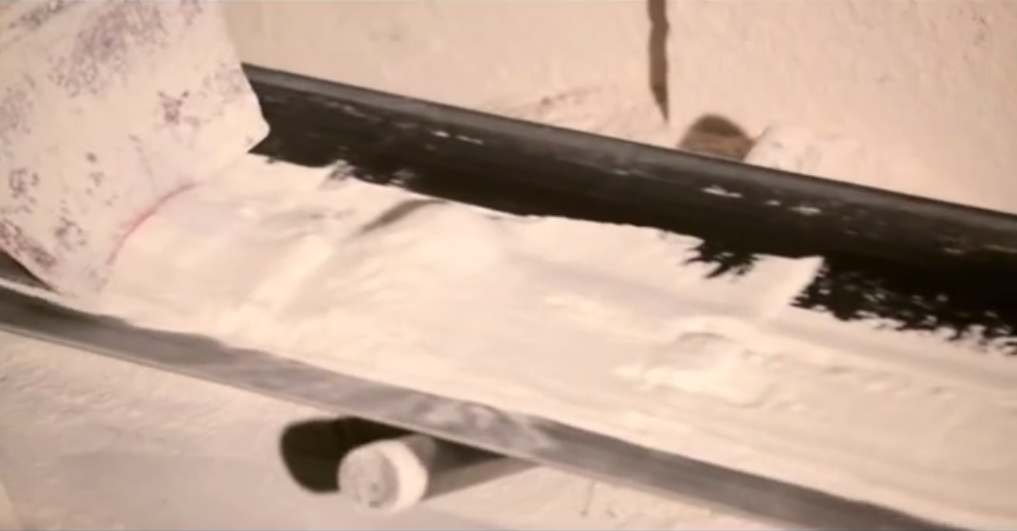

The finest clay powder is then sent to a pressing machine via conveyor.

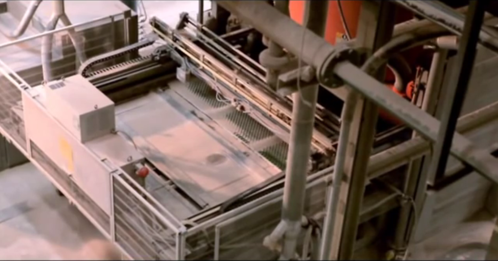

Once the command is given, a fully automatic pressing machine fills the mould with moist powder of clay and presses it to required pressure and sends it forward through roller conveyor for further processing machine.

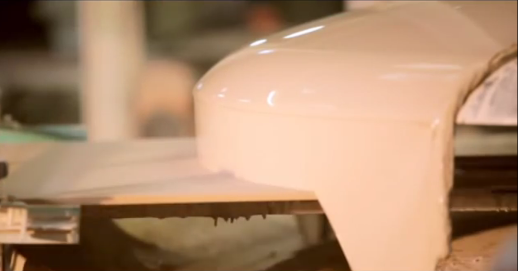

The push tile further here is called as green tile or biscuit.
We can have any shape in the back of tile and can be given in the mould, the top of the tile is plain or have designs on it (rustic tiles) to give the feeling of natural stone.
Rustic finish tiles are slightly costlier as the surface is not plain and the process of its topping do add additional costs but it gives a natural rock filling on top of it.

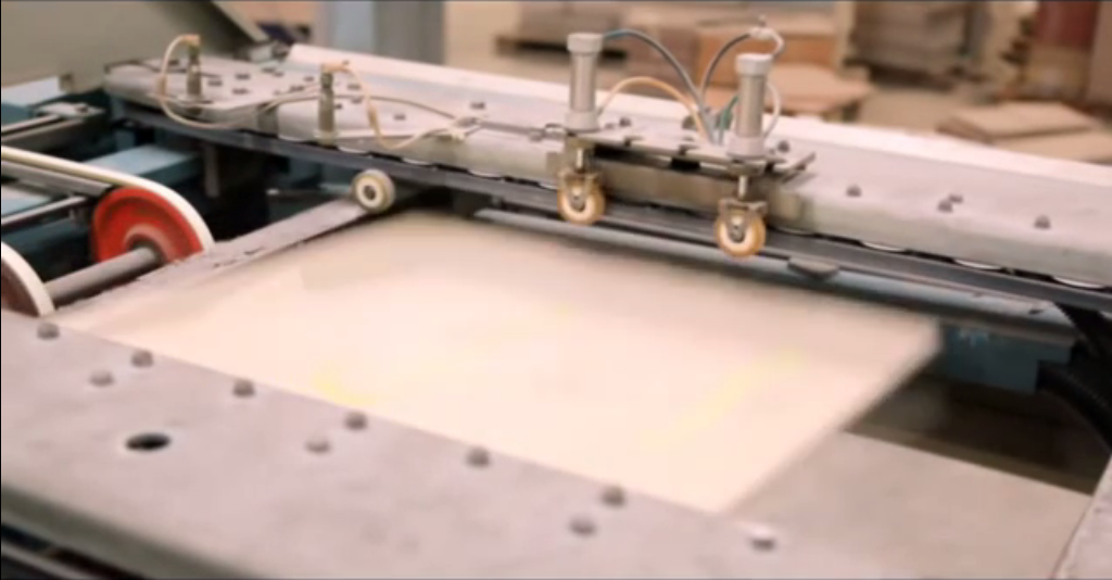

Must know – the size of the moulded tiles is always more than that of required size, generally they are made 15mm + on higher size coz during pressing, there is a chance that tile ends may lift upwards and in further processes may get some defects which can be nullify by cutting it after topping / printing.

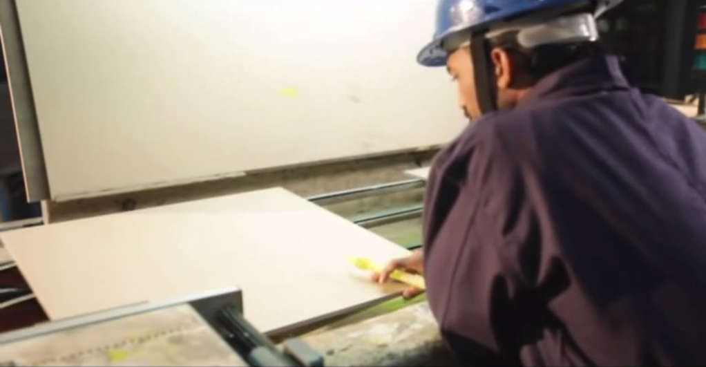

The green tiles then further goes from a drier which removes it moisture content completely.
Once the tiles are reached on other end of drier, they are completely dry and does not have any moisture in it and ready for further processing.

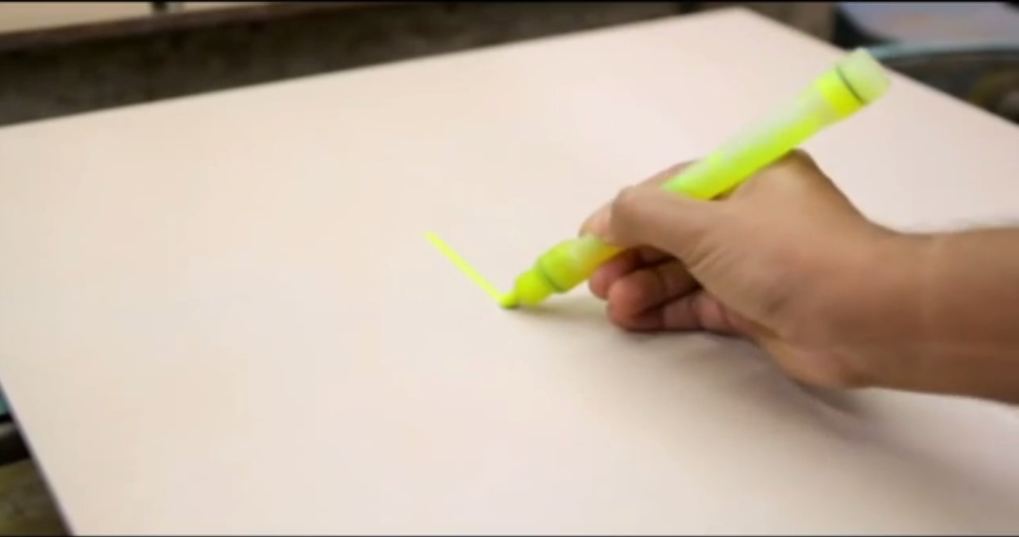

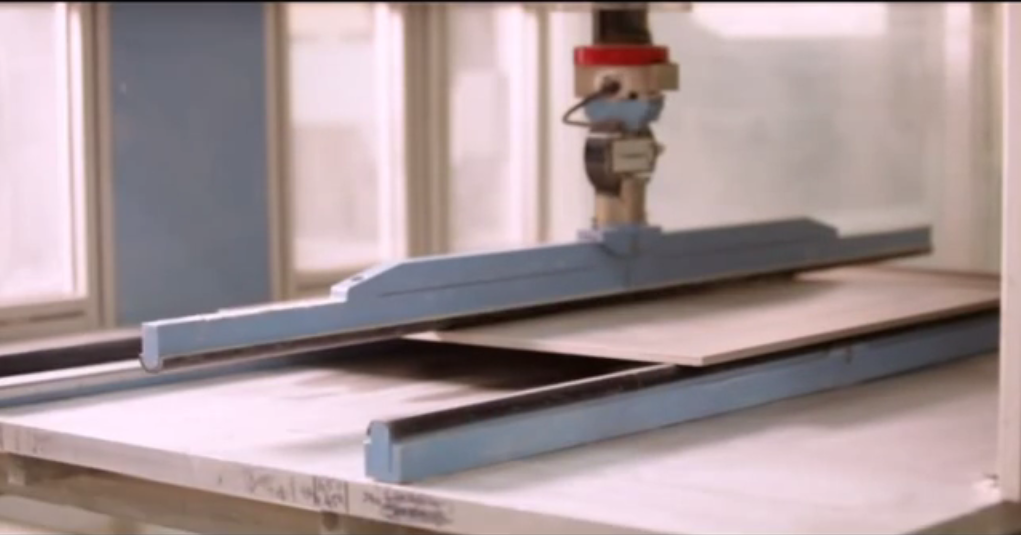

The green tiles are tested for its flexure strength to ensure the quality of batch.

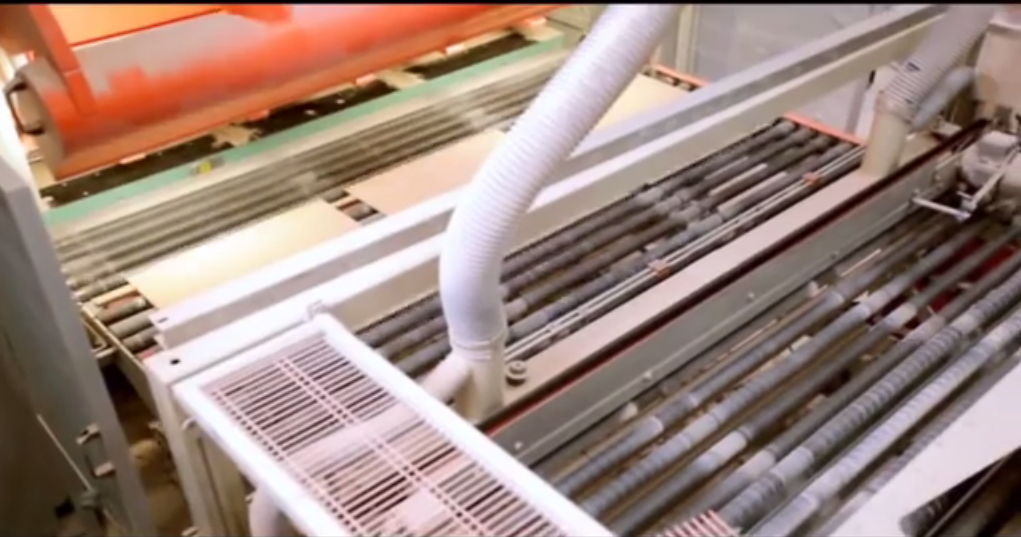

Dried tiles then coated with engobe, glaze and sent forward for printing. It can be either printed with rotary drum or digital printing machine.
Here onwards for each step of coating tile is first coated with adhesive and then air dried and each coating is done.
The green tile is then goes through a conveyor where adhesive is sprayed on it and air dried with fan.

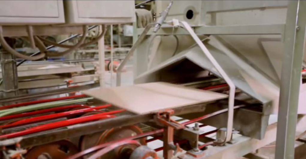

After this the engobe and glaze is applied on the tile surface.
Engobe is the main layer on the tile surface which ensure no leakages from top to back of tile or from back of tile to the top surface (it’s just like a waterproofing coat). When you see a wet patches on tile surface then it’s clear indication of improper engobe application on it.

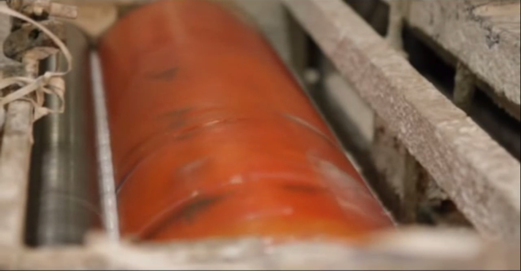

After engobe and glaze application tile is further moved to a printing assembly, it might be a roto type drum printer which gives color in 4 or more layer with adhesive application and drying before printing each layer.
In roto drum printer a color minerals are flowing through drums and when tile passes from the below of drum surface a layer of minerals is printed on it (just like how we apply paint on wall surface with roller brush)
Below photo shows assembly of 4 roto drum printer.
There are two technologies to print the design on tile surface
Roto Drum printer – As it’s a rotating drum which impress the color on tile surface, we can’t make a same design print on each tile surface and all tiles have different combination of surface texture (more likely they looks same), with this technology we cannot have fancy or more designs printed on it. This is use to give finish on the flat or rustic surface tiles.
Digital printing – In digital printing we can mimic almost any style, color combination and any type of surface finish look (we can make it as to look like wood, aluminium etc). After application of englobe the tiles are sent through a giant digital printer where the program automatically prints the design on each tile surface as per the design, with this technology we can print anything on tile surface, we can make a your photo printed on tile or printed in parts on tile which makes combination of 12 tiles to show what is the photo.

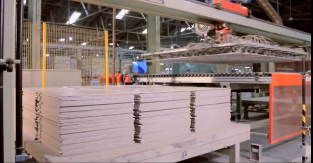

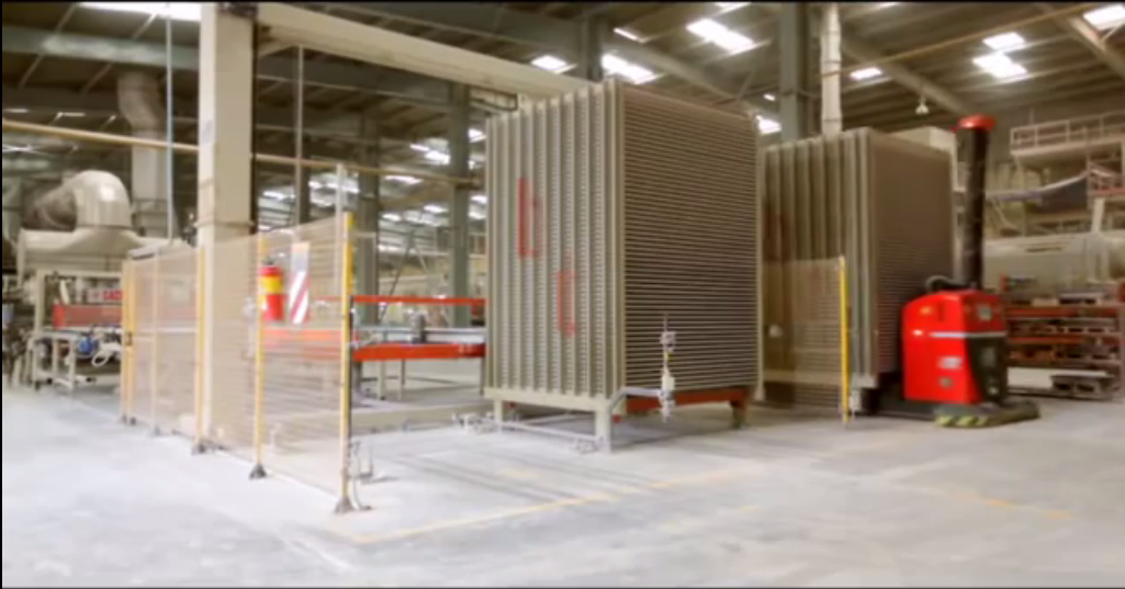

After completion of printing on tile surface, the automatic laser guided robots stack them and move to a kiln where heating of tiles is done.

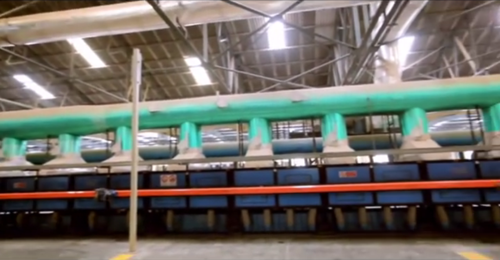

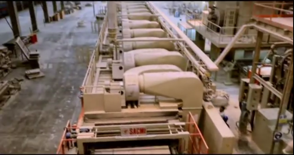

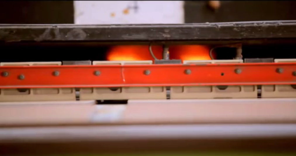

After stacking tiles they are further moved to heat treatment through a roller conveyor, tiles are heated up 1200 degree for ceramic and 1350 degree for vitrified. Tiles are heated in 5 different temperature zone in kiln of length 145 meter.

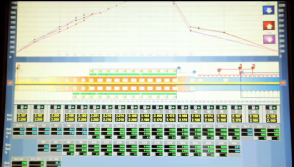

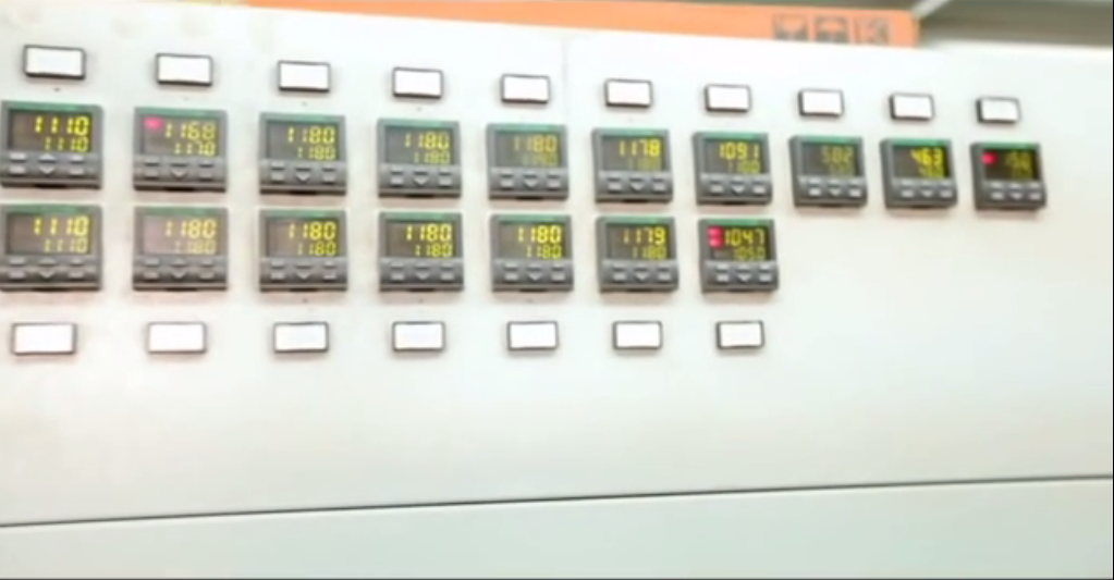

At each steps firing temperatures are controlled automatically and can be monitored on computer screen or in control panel.

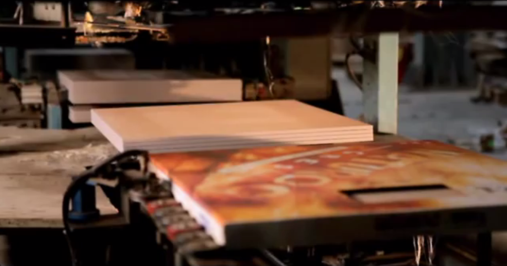

Then tiles are moved further by laser guided robot to cutting and chamfering assembly, where a final touch to the tile is given for its size and chamfered edge.

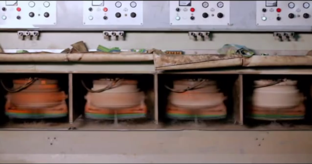

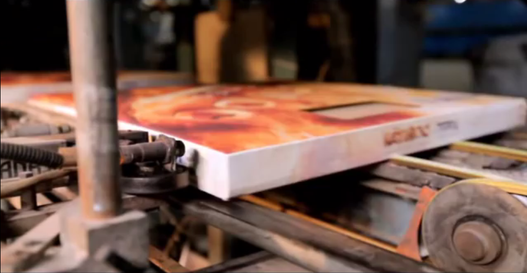

Some tiles do have lapato finish on top of it, which are done using polishing head assembly. This treatment gives a unique texture and natural finish to each tile.

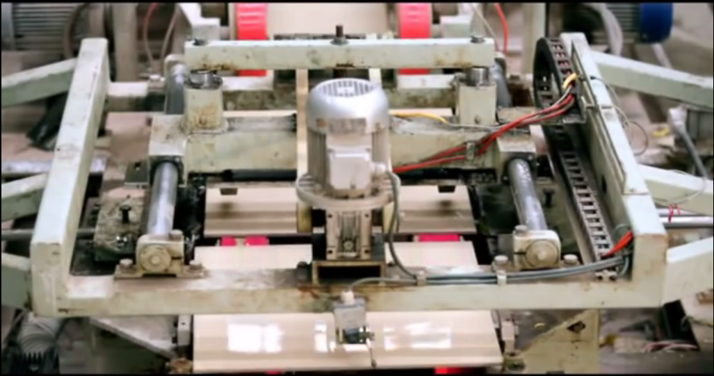

The tiles them move from roller conveyor into a cutting and chamfering machine.

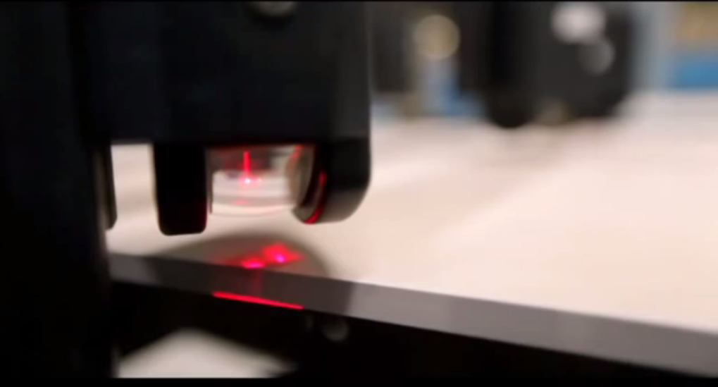

Then its moved forward through a roller conveyor where first the lasers check the properties of tiles and discards the tile which have defects in it.

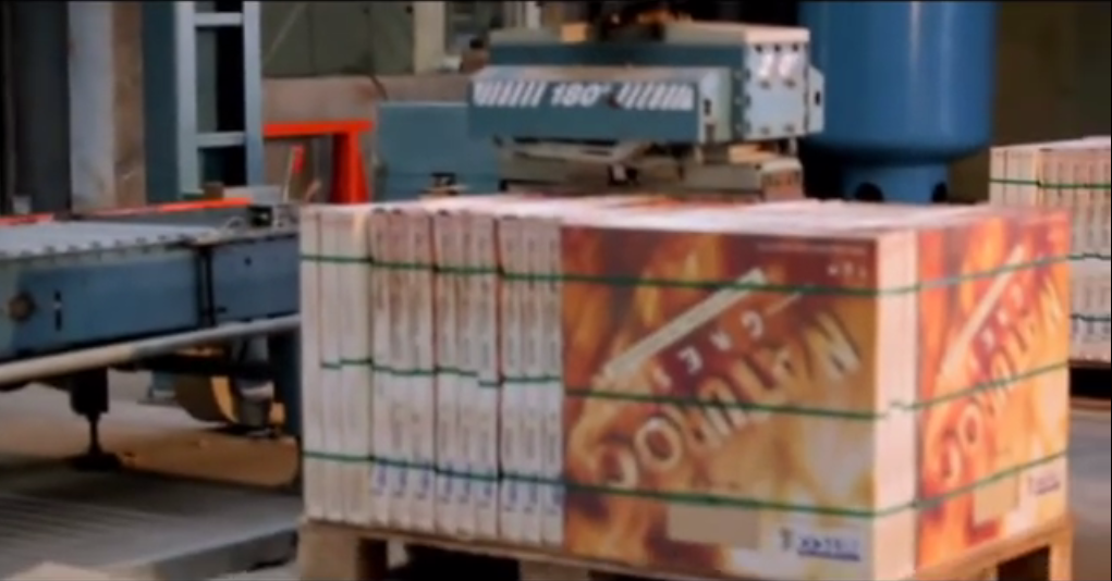

Packed boxes then further moved on conveyor and strap with automatic strapping machine.

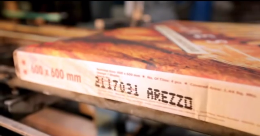

After strapping the boxes, batch number is printed on it.

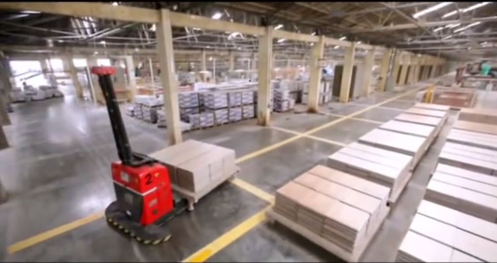

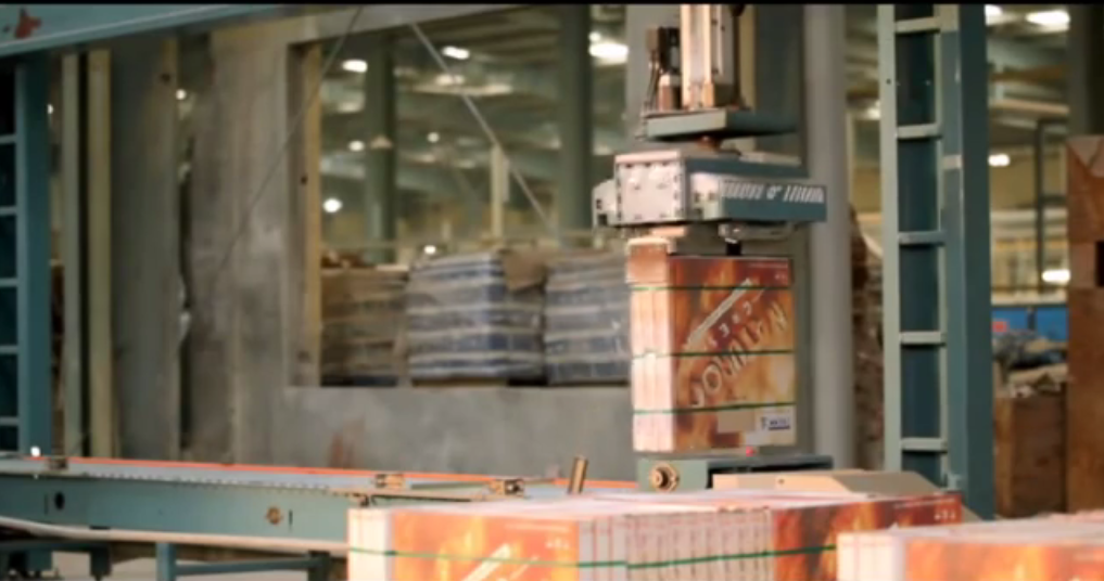

Then packed boxes are moved through a conveyor, where robotic hand stack them in pallet which are ready to transport.

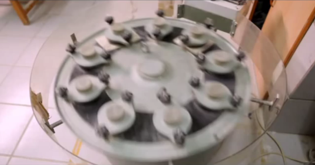

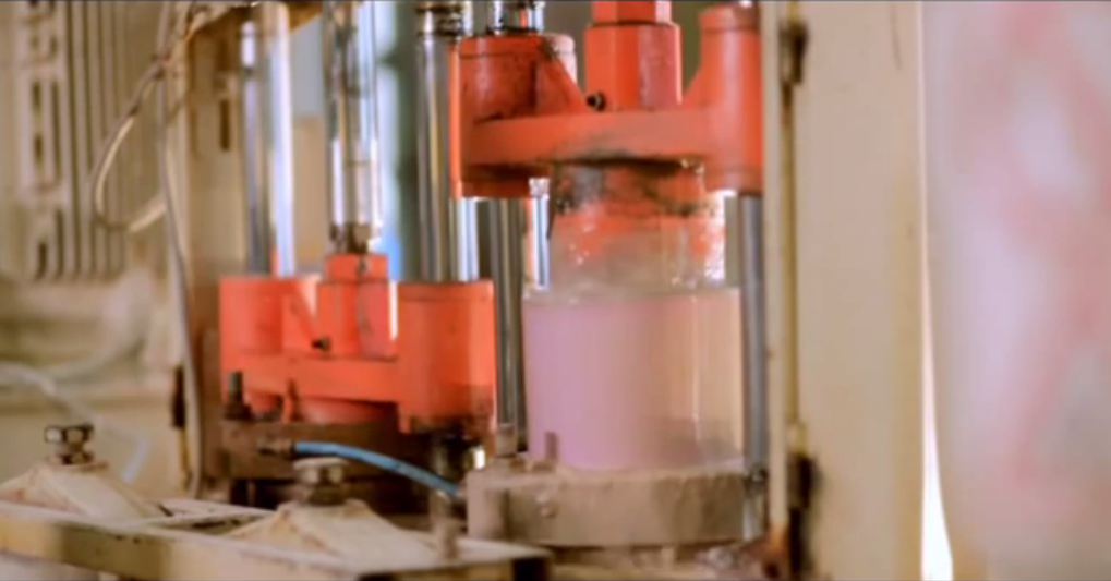

The sampling of tile is done and tested in lab for defects, size, thickness, abrasion value, flexure value and crazing resistance etc.
