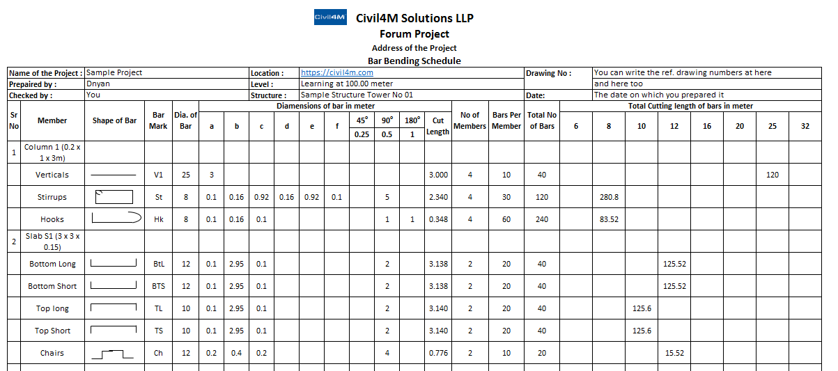

I have created a Bar bending Schedule format in excel sheet, which can be used for followings;
Taking approval from Client or Engineer Incharge - Its a Certificate which allow workmen to do work accordingly.
Ordering the required reinforcement steel Quantity.
Issuing Steel bars to contractor as per BBS and avoiding overdoing and wastage.
Reconciliation of done work and identifying the issues in cutting and bending of steel.
It does a great help to fitter to do cutting and bending as all dimensions and cutting length already provided to them in BBS.
It increases productivity of reinforcement workmen and hence reduce the delays in construction activities.
Above picture shows what it consist of.

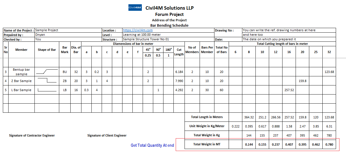

Once you enter the desired data like, member details, shape of bar, bar mark (you can put any, it helps you to tagging the lot and keep it properly till its shifted to actual work position),Diameter of bar, Dimensions of bar and number of bends according to angle of bend, number of members and number of bar per member, this excel program does rest calculation automatically and gives you total steel required as per diameter in Meter, Kg and metric ton along with the cutting length of each shape bar.

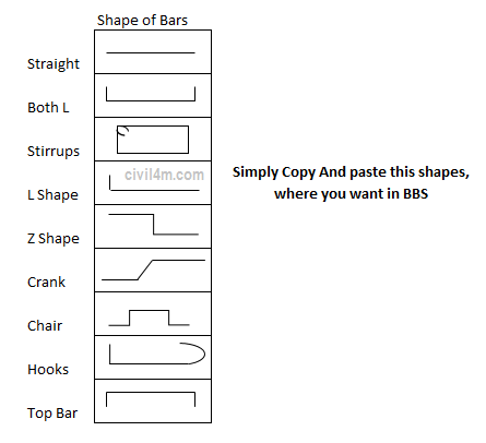

To make your work easy, we have added some basic shape on another sheet in that excel, from where you can simply copy and paste shape of bar to increase productivity. If you do not find your desired shape of bar you can create new in that list and use it as ready reference.
