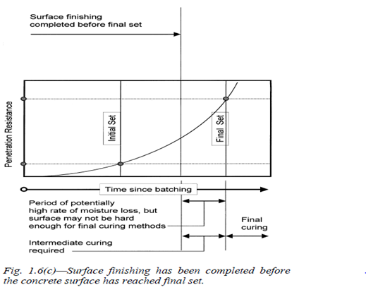

Concrete Curing should start as soon as the placing and finishing process is done (initial Curing) as if the concrete left without curing it will shrink as it dry due to surface tension of the water, drying shrinkage cracks will get developed at the surface of concrete.

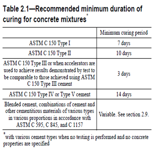

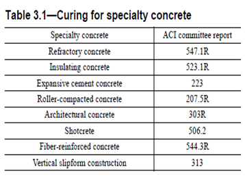

ACI 308 Guide to Curing Concrete
Curing temperature also is an very important issue specially within mass concrete applications The curing period may depend on the properties required of the concrete, the purpose for which it is to be used, and the ambient conditions, i.e the temperature and relative humidity of the surrounding atmosphere.
