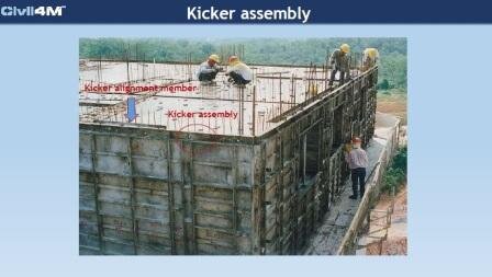

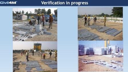

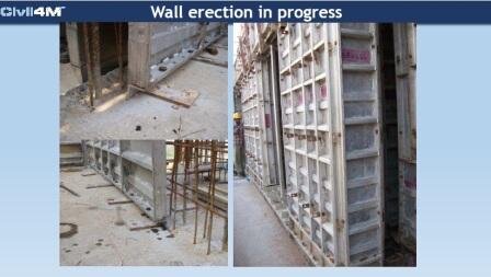

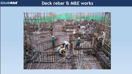

Reinforcement activities in aluminium formwork, when and how to do it.

-How to inspect and accept lots of aluminium formwork received at site and verification of each component.
-How to stack verified material in stack yard.
-How to start formwork erection at site.
-What are the setting out principals to be followed in aluminium formwork activity.
-Why timber stays are fixed in setting out, Use of kicker panels.
-Shuttering, deshuttering and shifting of formwork.
