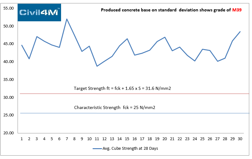

Standard deviation is a measure of the variation of concrete strength of a set of data from its mean.

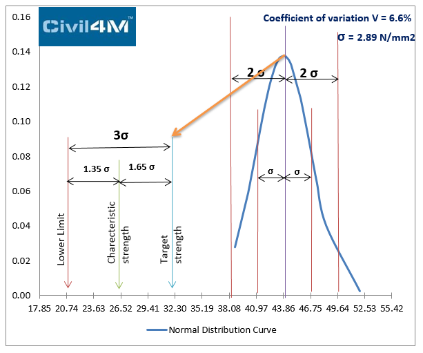

it is similar to six sigma process where we plot a normal distribution curve to get a better idea about spread and deviation.
If the strength results are away from the mean, the deviation will be higher and vice a versa.
Its a statistical measure for Re-designing the mix base on results achieved.
In initial mix design process, where actual standard deviation is not known, we use to take it from the relevant codes as per our degree of quality control.
It is denoted as "σ".
Once, we get actual results of at least 30 set, we then check for actual standard deviation and accordingly correct the mix proportions.

Sir Please guide:-- From 1st Graph, you have mentioned the "Produced concrete base on standard deviation shows grade of M39". How to decide that the Mix Design is of M39?
harish456
Apprentice
Sir, the strength of concrete exceeds or lower the limit of +/- 15% of average strength it indicates results are invalid as per 456-2000 and 516....
harish456
Apprentice
For m25 grade 25n/mm2 is required at 28dsys strength ,higher values not required beyond the limit of 31.6 n/mm2 then the mix is not economical right sir......
