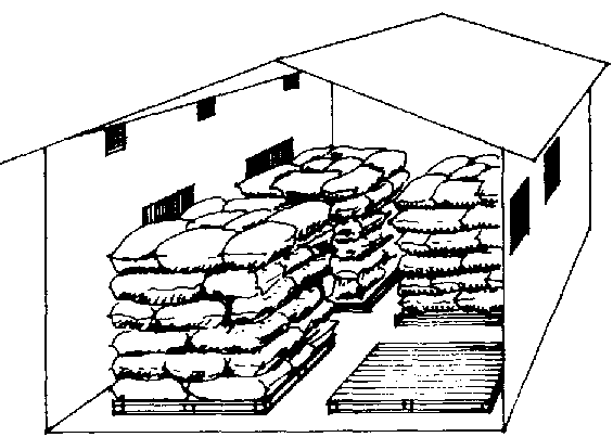

Below article could help you in understanding basic guidelines for storage of cement.
As we cannot quantify the effect of hydration on each bag of cement after storing it for 3 month from the date of manufacturing, it is not only difficult to predict which bags are good or bad or consuming bags by collecting there parts, normally that cement is not used for structural concrete purpose.
Cement can be utilised for finishing works base on your experience and knowledge about degree of infection (hydration) happened on cement bags.
After analysing the degree on infection, you can safely tag it for using either for plastering works, brick works or other finishing works or just for patch works.
