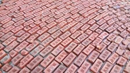

In conventional water proofing we use brick bats.
Waterproofing is actually a base coat which is applied on the surface of slab - if its not done correctly, then your slab will leak for sure.
Brick bat is a layer for absorbing sound, heat and any impact which may happen accidentally.
The top layer is the finishing coat of this protecting system which ensure proper sealing of it from all around.
