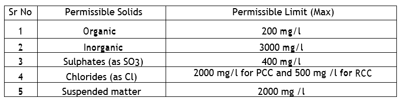

IS 456 –2000 stipulates the permissible limits of solids shall be as follows. (Table 1, Clause 5.4)
In case of doubt regarding the usage of water the same can be tested for setting time and compressive strength test as mentioned below.

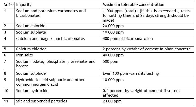

Apart from the above permissible limits SP 23 specifies the following concentration of some impurities in mixing water which can be considered as tolerable (SP 23, Table No 16, Clause 2.3).

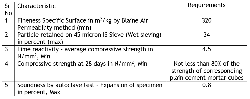

FLY ASH
Chemical requirements
When tested according to IS 1727 fly ash to confirm the following requirements (As specified in IS 3812 Part I, Table 1, Clause 5.1 and 6.1).
Physical requirements of fly ash (As specified in IS 3812 Part I, Table 1, Clause 5.1 and 6.1).
NOTE — Fly ash of fineness 250 m2/kg, Min is also permitted to be used in manufacture of Portland pozzolana cement by intergrinding it with Portland cement clinker if the fly ash when ground to fineness of 320 m2/kg or to the fineness of the resultant Portland pozzolana cement, whichever is lower.
