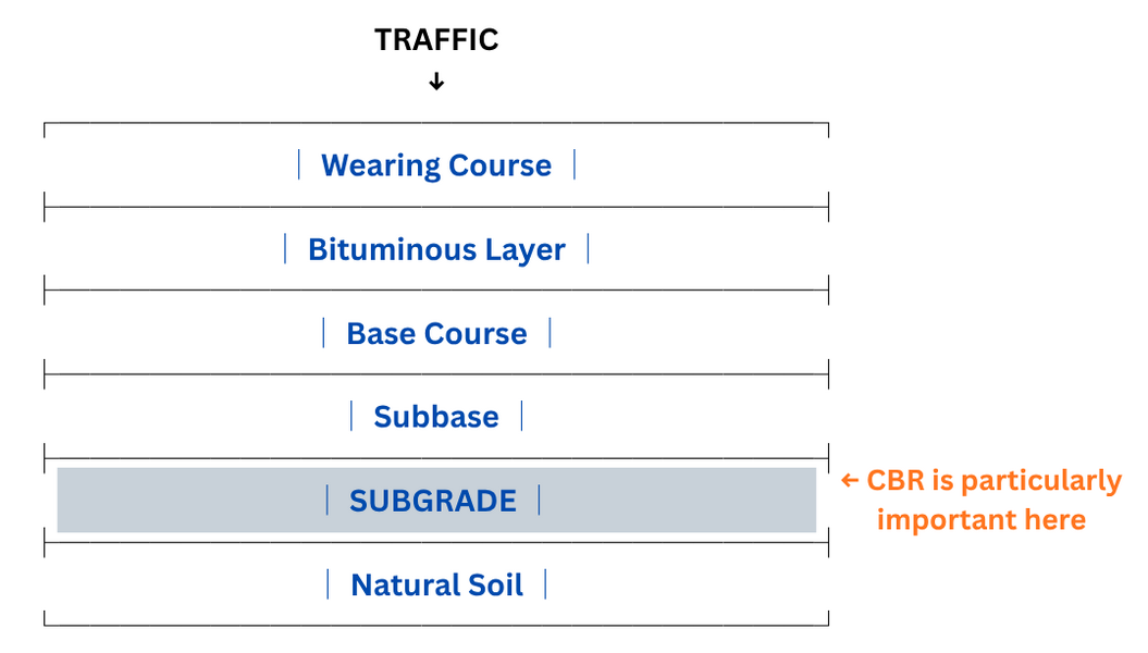

Where does California Bearing Ratio Apparatus fit into a road?​
Consider a typical flexible pavement :
The pavement distributes traffic loads over a progressively larger area as the load travels downward.
The subgrade therefore does not simply "carry the wheel load directly." Instead, it receives a stress distribution through the pavement layers.
If the subgrade is weak, the pavement generally requires a different structural configuration than it would over a stronger subgrade.

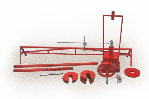

California Bearing Ratio In-Situ​
In California bearing ratio insitu testing, the test is performed directly on the soil or pavement material in the field rather than on a remoulded laboratory specimen.
BIS lists IS 2720 (Part 31):1990 – Field Determination of California Bearing Ratio as the relevant Indian Standard.
ASTM also has a separate method for in-place CBR, ASTM D4429. ASTM describes field CBR as useful for evaluating the relative strength of in-place subgrade, subbase and some base-course materials.

Instrument used - In-situ California Bearing Ratio Apparatus131_AIM_155_California_Bearing_Ratio_Test_Apparatus__Field_Type3.png
An important practical point is that a laboratory CBR and an in-situ CBR should not automatically be expected to be identical. Moisture, density, structure, drainage and construction history can all influence the result.
ASTM specifically warns that changes in water content, density or construction activity can affect the applicability of in-place CBR results.

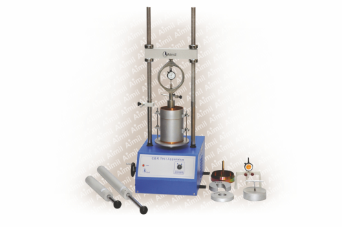

California Bearing Ratio Test Apparatus​
The main equipment includes:
Equipment and its purpose
  • CBR mould - Holds the soil specimen
  • Base plate - Supports the mould
  • Extension collar - Provides additional height during compaction
  • Spacer disc - Creates the required specimen arrangement
  • Compaction rammer - Compacts the soil
  • Filter paper - Separates soil from perforated components
  • Surcharge weights - Simulate pavement overburden
  • Expansion measuring device - Measures swelling
  • CBR loading machine - Applies penetration load
  • Penetration plunger - Penetrates the soil
  • Proving ring/load cell - Measures load
  • Dial gauge/displacement gauge - Measures penetration
  • Sieves - Prepare soil particle size
  • Weighing balance - Determines sample/mould mass
  • Mixing tray/bowl - Mixing soil and water
  • Soaking tank - Soaked CBR preparation
The IS method specifies a loading machine capable of maintaining a penetration rate of 1.25 mm/min and a penetration plunger of approximately 50 mm diameter.
