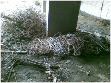

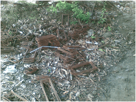

Have you ever wondered, why some fitter keep on making stirrups / Rings.
If you look at it closely, you will find that the fitter makes rings without any calculations on how much required and what will happen if I make more stirrups than required (Steel is free, so it does not make him to worry).
He only concern with how much he made, base on that he get paid.
Same with other fitters too, they keep on cutting bars without thinking of wastage.

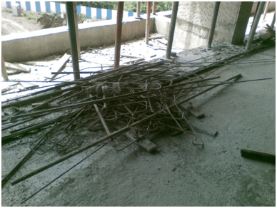

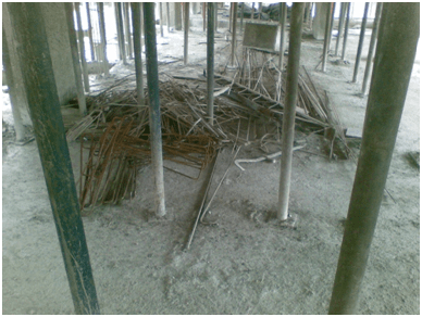

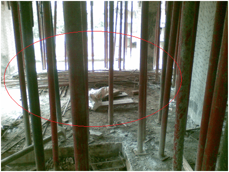

Reinforcement Bars should be cut and bend only in quantity specified on Bar Bending Schedule and to achieve this only specified number of bars given to contractor for doing work and each day reconciliation of it to be done before providing him next number of bars required for next work.
If you had ever taken round on project site and observed it (I am not saying about just simply visiting by keeping mind at home), You will find Cut steel bars, rings / stirrup etc abandon everywhere, around building, on each floor (Even if work is going on at 20th floor you will find steel on 1st floor, in any amount from less to large quantity and not even stacked properly)
When Bell rang from top, all of sudden everyone get to task to clean floors and then those bars, stirrups are collected and thrown to one place just like it’s a waste (No one goes to that stack to do sorting and using it, this happens for 2 or 3 days when issue is hot, later all goes into wastage and we scrap it).
Why steel bars seen everywhere when work is going on only at 1 floor?
We only see and do not observe. If we make observations, you will not have scrap at your project.
