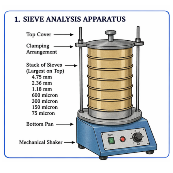

The sieve analysis test begins by collecting a representative soil sample, which is oven-dried to remove natural moisture.The dried sample is then gently broken down so that individual particles are separated without crushing them.
A stack of standard sieves is arranged in descending order of size, typically from 4.75 mm down to 75 microns, as specified by IS 2720 (Part 4) under the Bureau of Indian Standards.
The soil is placed on the top sieve, and the stack is fixed in a mechanical sieve shaker. The shaker is operated for about 10 to 15 minutes, allowing particles to segregate according to size.
After completion, the material retained on each sieve is weighed, and the percentage passing through each sieve is calculated.
These values are used to plot a grain size distribution curve on semi-logarithmic paper.

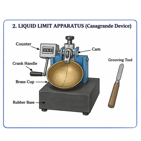

Liquid Limit & Plastic Limit Tests (Atterberg Limits)
Liquid Limit & Plastic Limit Tests Atterberg Limits Test Procedure
For the liquid limit test, soil passing a 425-micron sieve is mixed with water to form a uniform paste. This paste is placed in the brass cup of the Casagrande device and divided using a standard grooving tool.
The crank is rotated at a constant speed, and the number of blows required to close the groove over a 12 mm length is recorded.
The test is repeated at different moisture contents, and a flow curve is plotted to determine the liquid limit at 25 blows.

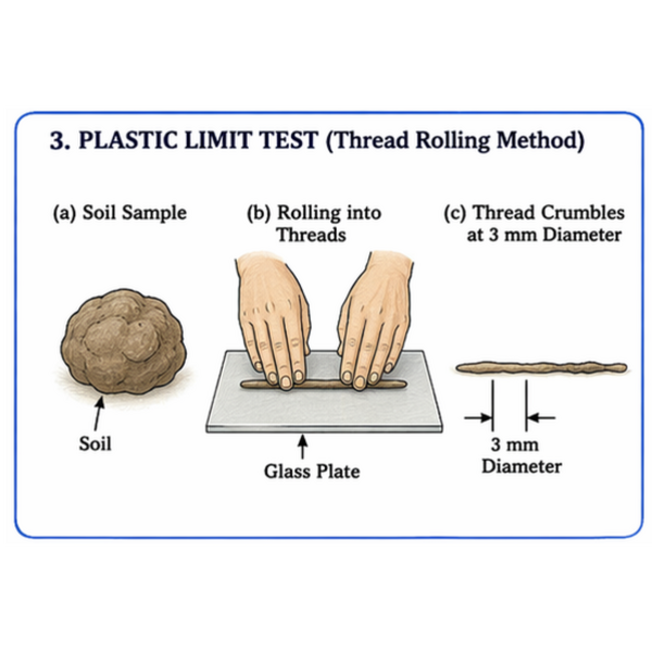

For the plastic limit test, a portion of the same soil is rolled into threads of 3 mm diameter on a glass plate.
When the thread begins to crumble at this diameter, the moisture content is determined. Both tests follow IS 2720 (Part 5) specified by the Bureau of Indian Standards.

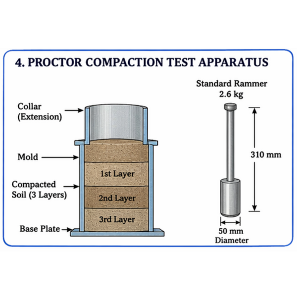

In this test, air-dried soil is mixed with a known amount of water and placed into a cylindrical mold in three equal layers.Each layer is compacted using a standard rammer with a specified number of blows.
After compaction, the bulk weight of the soil is measured, and a sample is taken to determine moisture content. The procedure is repeated with increasing water content.
Dry density values are calculated for each trial, and a curve is plotted between dry density and moisture content.
The peak of this curve gives the Maximum Dry Density (MDD), and the corresponding moisture content is the Optimum Moisture Content (OMC), as per IS 2720 (Part 7) from the Bureau of Indian Standards.
