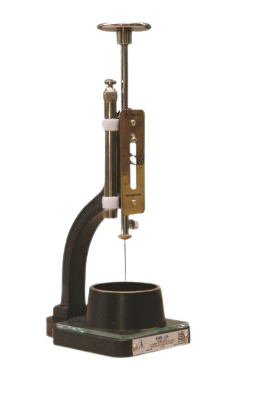

The Vicat apparatus is the main instrument used to determine the standard consistency of cement. It consists of a movable rod, plunger, scale, mould, and base plate.

Vicat apparatus is used in testing the Standard Consistency of CementWhat Is the Vicat Apparatus?

A 10 mm diameter plunger is used for the standard consistency test.What other tools are required along with the Vicat Apparatus to determine the standard consistency of the given cement?
Other tools include:- Vicat mould
- glass plate
- weighing balance
- measuring cylinder
- stopwatch
- trowel or mixing tray
